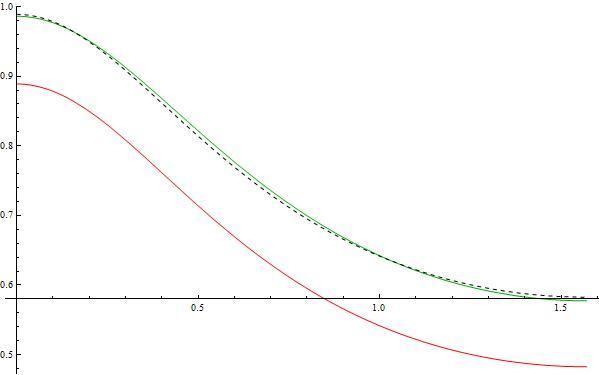

Ok, I left out some things. Let me rephrase the question independent of flying: given a function, we seek to find a second function such that the second function has a curvature that is the curvature of the first function plus some constant. Let's start with my ellipse: [itex]R(t)=3 \cos(t)i+2\sin(t)j[/itex]. Now, the expression for the curvature vector is complicated and I just did it all in Mathematica. I eventually come out with the curvature function [itex]c(t)[/itex] which I plotted below in red. Now, suppose we want to find another function such that it has a curvature function that is [itex]c(t)+0.1[/itex] indicated by the dashed black line. Now, what function, any function cus' we're not proud, would produce a curvature function which would track the black dashed line? Let's just try to guess that it's a smaller ellipse [itex]R_2(t)=h \cos(t)i+k \sin(t)j[/itex]. Now, how do we find h and k? Well, for starters now, just guess at them. In Mathematica, we can set up a Manipulate function that can vary h and k interractively and I can do that until I get my new function to line up close to the dashed lines. I did that which is shown in green:
[tex]R_2(t)=1.732 \cos(t) i+1.014 \sin(t)j[/tex]
It's not perfect but when you're starting, it's encouragement. Also, the curvature is in radian measures I think so if you want it to be 5 degrees more, then I suppose we need to have [itex]c(t)+\frac{5\pi}{180}[/itex]
You know how to transfer [itex]R_2(t)[/itex] to a piece of wood? Not an insulting question right? Get the ellipse you want in terms of [itex]R_2(t)[/itex], plot the points on a large transparent grid, connect the points, move it to the wood, cut it out. I'm sure you'll make sure everything is [itex]10^{-6}[/itex] accurate before you fly it. :)

That's interesting, that a smaller ellipse would be the solution as far as curvature goes, but it misses an important constraint--the curve length needs to be the same--I have an airfoil of a certain length, and can't change that.
Any easy solution to that? It may turn out that it's not even a function--it may double-back on itself.
I've plotted a curve for the airfoil I'm trying to achieve in Maya, and using Mel, Maya's embedded programming language, I've been able to calculate the radius of curvature at any point along the length of the airfoil curve.
The problem is, I haven't figured out how I can use that information.
I managed to code this in Maya in a sort of iterative fashion. Depending upon the value of bounceback used, it will curve more or less, even into a spiral, and the length of the curve stays constant. Thanks for your help on this, Jackmell, very kind of you.
