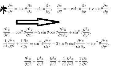

So I've begun by trying to take the 2nd derivative of [itex]\frac{\partial z}{\partial r}=\cos\theta\frac{\partial z}{\partial x}+\sin\theta\frac{\partial z}{\partial y}[/itex]
Which gives me this: [itex]\frac{\partial^{2}z}{\partial r^{2}}=-\sin\theta\frac{\partial z}{\partial x}+\cos\theta\frac{\partial^{2}z}{\partial x^{2}}+\cos\theta\frac{\partial z}{\partial y}+\sin\theta\frac{\partial^{2}z}{\partial y^{2}}[/itex]
I've tried playing around a little but can't seem to get it in the form shown. I can see the form is something like (a+b)^2 but can't mimic this...
Have I done something wrong?

you seem to be using the product rule instead of the chain rule :redface:

I don't see how I would use chain rule here.
never mind ∂z/∂x and ∂z/∂y
what is ∂/∂r in terms of ∂/∂x and ∂/∂y ?

nooo, it's [itex]\frac{\partial}{\partial r}(\frac{\partial z}{\partial r})=(\cos\theta\frac{\partial}{\partial x}+\sin\theta\frac{\partial}{\partial y})(\cos\theta\frac{\partial z}{\partial x}+\sin\theta\frac{\partial z}{\partial y})[/itex]
(what you wrote is correct, but it's just a product
what i've written is a derivative :wink:)​
anyway, show us how you expand this :smile:

i'll say it again …
it's [itex](\cos\theta\frac{\partial}{\partial x}+\sin\theta\frac{\partial}{\partial y})(\cos\theta\frac{\partial z}{\partial x}+\sin\theta\frac{\partial z}{\partial y})[/itex]
expand this
I know that when expanded that becomes [itex]\frac{\partial^{2}z}{\partial r^{2}}=\cos^{2}\theta\frac{\partial^{2}z}{\partial x^{2}}+2\sin\theta\cos\theta\frac{\partial^{2}z}{\partial x\partial y}+\sin^{2}\theta\frac{\partial^{2}z}{\partial y^{2}}[/itex] (the answer) but I don't get how we go from [itex]\frac{\partial^{2}z}{\partial r^{2}}=\frac{\partial}{\partial r}(\cos\theta\frac{\partial z}{\partial x})+\frac{\partial}{\partial r}(\sin\theta\frac{\partial z}{\partial y})[/itex] to that.

You should think of ∂/∂r[] as an "operator": something that operates (acts on) a function. When you stick the function f(r,θ) (or f(x,y) equivalently) into this operator (i.e. into the square brackets), the operator differentiates that function w.r.t. r. So, in this problem, what you're being told is that the operator ∂/∂r[] can be expressed in Cartesian coordinates as:$$\frac{\partial}{\partial r}\left[~\right] \equiv \cos\theta \frac{\partial}{\partial x}\left[~\right] + \sin\theta \frac{\partial}{\partial y}\left[~\right]$$
So, in the equation quoted above, everywhere we see ∂/∂r, we can replace it with the equivalent differential operator expressed in Cartesian coords:$$\frac{\partial^{2}z}{\partial r^{2}}=\frac{\partial}{\partial r}\left[\cos\theta\frac{\partial z}{\partial x}\right]+\frac{\partial}{\partial r}\left[\sin\theta\frac{\partial z}{\partial y}\right] $$ $$= \cos\theta \frac{\partial}{\partial x}\left[\cos\theta\frac{\partial z}{\partial x}\right] + \sin\theta \frac{\partial}{\partial y}\left[\cos\theta\frac{\partial z}{\partial x}\right]+ \cos\theta \frac{\partial}{\partial x}\left[\sin\theta\frac{\partial z}{\partial y}\right] + \sin\theta \frac{\partial}{\partial y}\left[\sin\theta\frac{\partial z}{\partial y}\right]$$
Can you take it from here?

i don't understand why you're doing all this :confused:
2z/∂r2
= ∂/∂r(∂z/∂r)
= [itex](\cos\theta\frac{\partial}{\partial x}+\sin\theta\frac{\partial}{\partial y})\left((\cos\theta\frac{\partial}{\partial x}+\sin\theta\frac{\partial}{\partial y})(z)\right)[/itex]
I know what I did wrong and I finally understand the question. I was taking the second derivative of dz/dr and used the product rule but r is independent of [itex]\theta[/itex] so when I treat [itex]\theta[/itex] as a constant I get the same answer as you.
Thanks again for helping me out guys! much appreciated.
