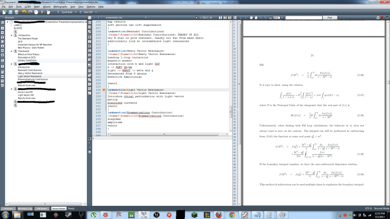

I use TeXMaker. I split chapters into separate Tex files, but this makes it a little tougher as you have to compile the whole thing for the preview.
But even without that, using chapter/section/subsection will make the structure appear in most good tex editors, and on the left you can just browse to it.
Also, when looking in the preview on the right, you can right click and "jump to tex" as well as the opposite in the code.
http://i41.tinypic.com/e82xpe.png
That left window with document structure is great - exactly what I'm looking for. It didn't work with my custom homework templates though as I'm using some other structure ( "problem" instead of chapter/section).
Also that jump to tex isn't working very well.
I think it's a software issue and I could probably work it out on my own.
If I sort that out then the only issue would be editing really big equations.
When I look at a whole bunch of equations thrown into a \begin{align} environment my eyes glaze and I have no idea what's going on. If I'm trying to edit something small in there it's a real pain!
How do you handle that?
