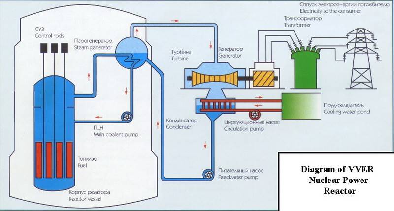

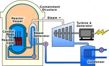

fascinating, this:
versus that:
Clearly a horizontal drum gives more surface area for the steam to dissociate itself from the water.
