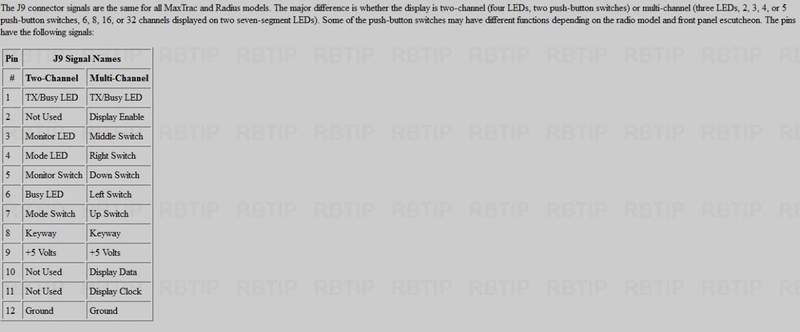

Thank you for the replies. Berkeman, I'm using this cable to remotely control the two way radio remotely. If you remove the faceplate, there is 25 pin total connector that runs to the actual transmitter unit. I'm not sure what each conductor does, but every one of them is wired between the control face plate and the actual radio. When I tried this, the radio came on and worked fine but I can hear slight noise coming through the audio along with the (2) 7 segment displays that aren't functioning properly. My next idea was to try and get 100 ft of actual DB-25 cable and see if it will work that way.

Hmm. That sounds like it may be difficult to do. There might be a way to make converter boxes at each end, with good quality serial communication on a set of twisted pair cables run between the converter boxes. Can you find the pinout and signal description, or is it likely a proprietary interface? What band is the radio for?
It is a Motorola Radius 16 ch 40 watt radio. It covers the 70cm ham band. I do have a pin out that shows what each pin is used for. Does twisted pair cable actually perform better in terms of capacitance buildup throughout longer distances?

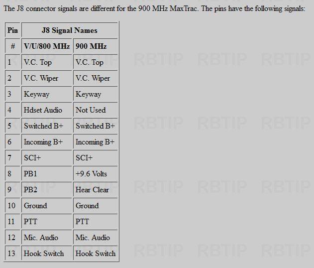

What are some of the signals? Can you post a scan of the pinout diagram and pin descriptions?

Since I have the multi channel radio, it looks like I'm trying to correct the communication in pins 12 and 13. All the other functions seem to work right. I can key the transmitter and see the tx light and receive light come on but the display and channel select isn't functioning.
It looks like you should drive the Display Clock & Display Data (and maybe the Enable signal too) as individual twisted pairs with terminations at the far end. You can use RS-485 differential drivers and receiver ICs to do the single-ended to differential conversion at both ends. Use Cat-5 cable to give you multiple twisted pairs in one sheath. You might also want to do the same with the SCI+ signal, if that is doing downlink TX comm in a RS-232 fashion.

That's about all I could find for the information. I'm trying to understand a little bit more on the possible scenario you gave me. Using my RS-232 DB 25 communication output, convert that to RS-485 and transmit those signals over CAT-5 twisted pair cable, then on the receive end convert the RS-485 signals back to RS-232? Am I understanding that correct?
Since the display has clock and data lines, that is not RS-232 communication. And for the SCI+ line, if that is RS-232 communication, it should work over that distance, I believe. The problem comes with unterminated digital lines -- there will be too much ringing to allow reasonable comm.
