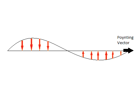

What I'm wondering is whether or not the E-fields and B-fields making up an EM wave always point outwards. Would it be possible to have an EM wave where either the E-fields or B-fields, or both, point inwards towards the path of propagation? The only diagrams I see in books and the internet alike either have them both point outward, or not have any indication of direction at all.

What do you mean by the fields pointing "outwards"? The fields are perpendicular to the direction of propagation.
I mean outwards away from the Poynting vector instead of inwards towards the Poynting vector.
:confused: The Poynting vector points in the direction of propagation. The E&M fields are perpendicular to that direction.

So normally we have the E-field vectors pointing away from the line along Poynting Vector.
I didn't draw the B-field, but you can imagine it's there.

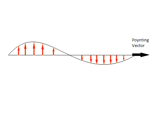

What I'm wondering is if this is possible:
Mathematically speaking, even if either the E-field vectors or B-field vectors pointed towards the Poynting vector so that their heads, rather than their tails, touched, a cross product can still be performed to find the direction of the Poynting vector. I'm just wondering if there is any physical laws saying you can't orient them head-to-head.

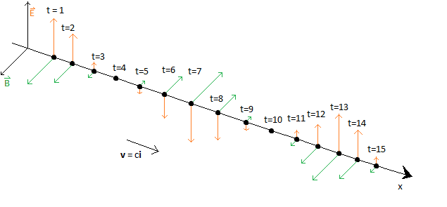

Ah! So you're merely misunderstanding what that picture actually means. The wave is NOT a single ray, but rather a plane wave. That same picture is happening at each and every point in space along the same plane that is perpendicular to the direction of travel. Imagine those arrows translate all up and down the plane so that any point perpendicular to the direction of motion has the same vector as all other points along that plane.
Then there is no longer a sense of inward or outward, because there is not actually a line along which to define the concept.
The wavy lines in your pictures are defined by the direction and magnitude of the E-field vectors, so the second picture doesn't make any sense - you're using the wavy lines to position the vectors instead of the other way around.
The correct way of drawing the second picture is to just flip the first picture about the axis of travel so that the arrows on the left point down and the ones on the right point up.
Always remember that in pictures like these, the x-axis is a direction in space but the y-axis is not. These aren't drawings of waves, they're graphs of field strength as a function of position.

@mathskier - Thanks, I never knew that! That makes a lot more sense. Although that makes me wonder, hypothetically speaking, what if we focused a beam of light so small that rather than a plane wave, it becomes a "point" wave, like a single photon, would we be able to use the same diagram to visualize the phenomenon?
Yes, because that diagram already is a graph for the field strength at a single point. Pick a point on the x-axis, say x=X0. The y-axis of that graph gives you the field strength at the point x=X0, y=0, z=0.
