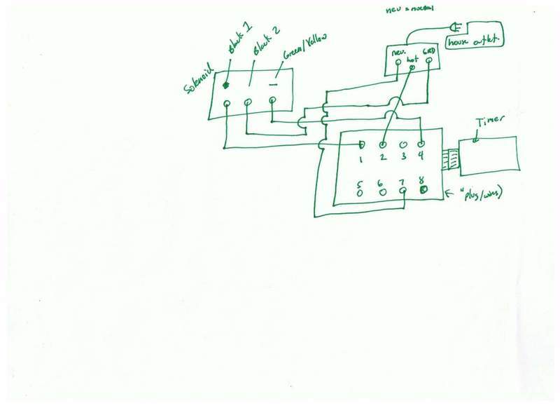

My team member brought this controller up and was wondering if you guys can double check this and see if it would work?
Ive also added the wiring schematics-this is pretty much how we plan to wire everything. please wiring expert look at these and see if this is correct.
here are the components. this is what were planning on using.

and here is the timer that was suggested.
http://www.galco.com/buy/Idec/GT3W-A33AF20Nand here is the wiring diagram

Since 2 and 7 on any typical base is the coil your solenoid would actuate (if it were wired correctly) whenever the timer told it to.
Why are you taking the neutral of the coil back to the relay base?

not my wiring diagram. this is what my team mate gave me. but I wanted to double check since these will be purchased and need to be 100% accurate.

Don't worry your circuit is simple. From the looks of your diagram you probably don't need to worry about centering and non centering. One returns to it's natural state once the voltage is removed from the coil. An internal spring forces the solenoid. The other requires the first voltage to drop out and then a second coil to return the solenoid to it's natural state. In application, this is a very important consideration.
I'm assuming you have a spring returned solenoid.
You have two coils in your circuit. One in the timer relay and one on your solenoid. Polarity (which side is neu what side is hot) will not matter in either case. You can put which ever to either side and your coil will become a magnet.
Typical what you see in a 120 VAC schematic is wire 1 is hot and wire 2 is neu. The #1 hot typical becomes #3 as it runs in series through an infinite number of safteys (interlocks). Once we get through that series circuit it comes back as #5. Very long explanation just know it's professional to keep neu #2. For this reason, you normally will put neu to the #2 point on your relay base.
The neutral from your solenoid has no reason to return to the relay base. Your neu from all three can just tie together in a terminal strip, wire nuts , what ever you have.
The non neu from your coil on the solenoid needs to go to the relay timer. You need to look at your timer and you will see on the top, side (some where on that timer) will be a diagram. You have timed and non timed contacts. Make sure you use timed.
On the timed contacts you will have three numbers. One is common to the other two. The common is either normally closed or normally open to the other two numbers. You want normally open. Put your solenoid coil wire there. Then, from point 7 on your relay base you need to put a jumper to the common point. Your done.
