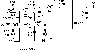

agreed, a specific module isn't going to be pulled and getting one made for 30.01MHz isn't going to be easy
but a discrete component crystal osc, say a Colpitts type can easily be
which is what I had in mind :)
in the days of working on the old Tait commercial, xtal controlled, tranceivers, they could easily be tuned over a 100 kHz.
this one here ...
part of a transceiver that I worked on regularly over recent years. Up to 50kHz at 35MHz operating freq wasnt too difficult :)
But I also agree with you DDS is a good way to go these days
Dave
