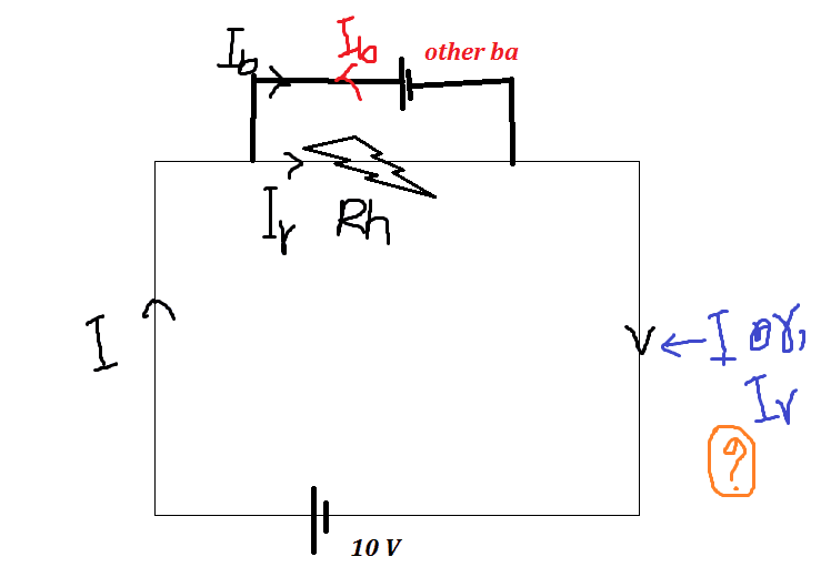

Here is a picture of the circuit... This is a screenshot of the part when Ib equals the current from the other battery...
PS: I should have said before 'Now we change the Rh so that Ib equals current from the other battery'... not the opposite... Sorry for poor choice of words... .

Well, if the power sources are not identical, that leads to a short circuit or not well-defined currents through the voltage sources.
Anyway, you can always use Kirchhoff's laws.
How is this a short circuit! There is resistance due to the Rh... I didn't understand that...
I know kirchhoff law... I also know wheatstone bridge :p ...
Actually I am confused cause I'm getting the answer Ir... Cause I am using my assumption that Ib and Ib are neutralizing each other... But is this the case?
Voltage sources define the voltage drop across them. You have two voltage sources with connected terminals - a circle without a resistance in it, but with a (possible) voltage drop.
You cannot calculate the currents in the voltage sources here. I don't think you mean "Ib and Ib", right?
Both of the two loops have a common resistor(Rh)... So which one is the 'circle' without resistance... I didn't understand that...
I meant the Ib from the 10 V battery and the Ib from other battery...
Are you saying there is not enough data to give an answer? I remain confused...
And please answer the question of the heading of this thread... when two equal electric current flow opposite to each other in a
wire what happens? Do they neutralise each other or what? I mean do they cancel each other out or what happens?
Yes, and so are we all due to the way you are presenting the question

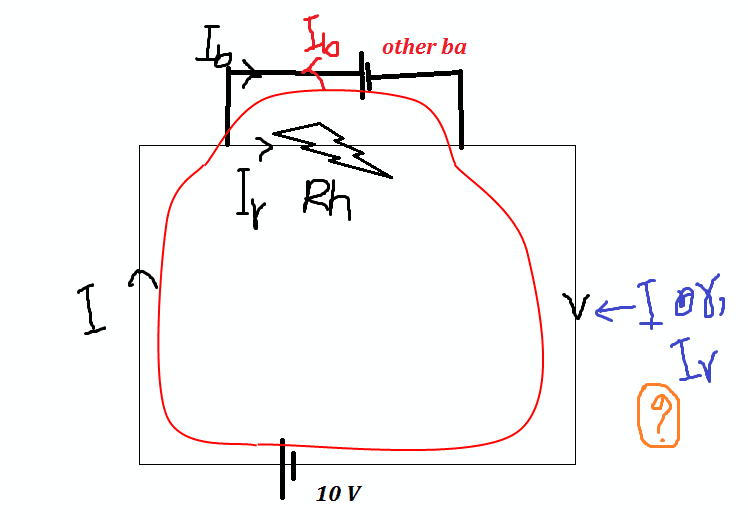

The red path has two voltages sources and no resistance in it...
Dave, I am not asking for a value... I am just asking for the current in the question marked portion... Isn't the data enough for finding that out? However, feel free to give suitable value to the unknown data (but do not give the other battery greater voltage than 10 V)
CWatters, yeah you're right... We should add a resistor in that path... Correcting that,now what's your thought about my question?

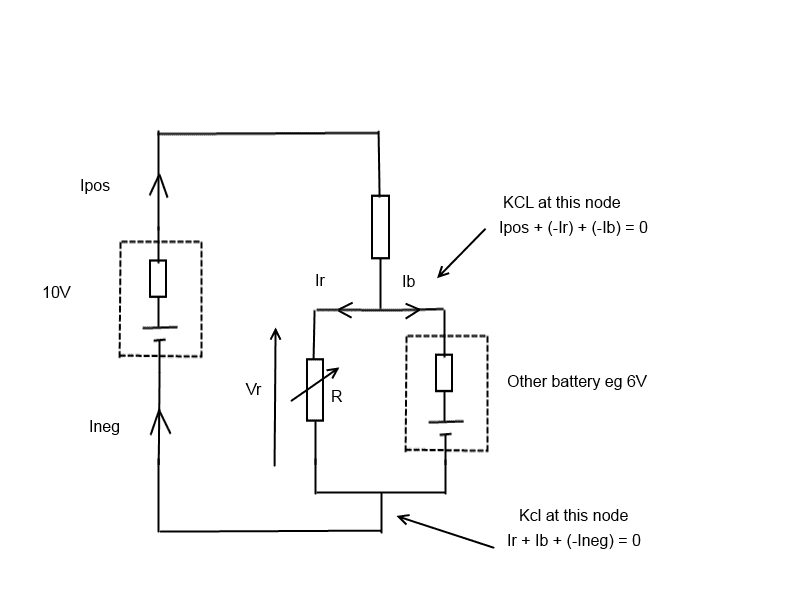

Ah I think I might begin to see your difficulty.
There is no separate current flowing out of the other battery. You don't get a two way flow of current.
In my equations Ib is the total current flowing through the "other battery" due to all causes including the effects of itself.
But shouldn't that(the neat current through the other battery) equal 0 then...
Cause two currents with same the value are flowing through the other battery...
Aren't these two batteries connected in parallel to the single load?
Yes the net current Ib could be zero. For example if R was adjusted until the voltage drop across R was equal the the voltage of the "other battery". We need to be a little careful because that cannot be done with your circuit due to the problem other people mentioned earlier (You have two batteries in parallel so the currents and voltages are large/undefined).
See the circuit below...
It shows two batteries (dotted) with their internal resistances. It is possible to adjust R until Vr = 6V. In that case Ib = 0. If you look at the right hand battery the voltage on both sides of it's internal resistor would be 6V. So no current flows through it.
At long last, we are talking about the problem... And thanks for mentioning internal resistance in the circuit,hence its not a short circuit...
What u have said now is exactly my question...what I needed to know is exactly what happens in the circuit while we change the Rh...
I thought first as we change the Rh at some point, current through the other battery due to the two batteries equal each other and cancel each other out... That leads us to a decreasing current in the circuit... But my text said we change the Rh so that the voltage drop across Rh equals the voltage drop across the other battery... Then I thought there shouldn't be current flowing throw the other battery then... I was confused... And two of my texts had their ammeter on the negative side of the circuit... So I thought okay,maybe my first explanation is correct... However, it seemed contradictory so I asked the question...
The explanation is I believe-
We changed the Rh in such a way that the voltage drop across the wire and across the other battery are equal to each other... So in the path across the other battery there is no voltage difference... So no current would flow through that battery... That means the complete Ipos would flow throw Rh and thus Ineg=Ipos.
Isn't that it?
And just to let you know the Rh resembles a potentiometer wire,the other battery a thermocouple and hence the 10 V battery cause usually 10V batteries are used in this kind of measurement with potentiometer...
What am I missing here?
Why mention of the batteries canceling?
The batteries are not in opposition, they are parallel, connected + to + and - to -.
Shorten all the leads until you notice that all you have is a variable resistor with one of its terminals connected to the positive on each battery, the other terminal connected to the negative of each battery.
Both batteries are applying like sign voltage to the same ends of the resistor.
I didn't ever say the batteries cancel each other... I only said one of my assumptions(which turned out to be wrong) was that the two equal current through the other battery cancel each other... It could happen given a certain Rh...
The other battery cannot give any current as there is no voltage difference between the end points of the wire...
And if u see the circuit of measuring thermal emf using potentiometer, it will be clear to you I think...
With reference to my last drawing. I would look at it like this...
If R is very very large (or it's removed) Vr will be > 6V. Some or all of the the current from the 10V battery will flow into the 6V battery. (eg It will charge the 6V battery).
If R is very small Vr will be < 6V. Some current will also flow out of the 6V battery through R. The total current through R will be the sum of the currents from the 10V and 6V batteries.
For some value of R the voltage Vr will be exactly 6V. So no current will flow into or out of the 6V battery. In this condition there will NOT be two current that cancel each other. Just no current flowing in the 6V battery.
EDIT: In fact in none of the three cases are there two currents flowing in opposite directions at the same time. Batteries approximate to constant voltage sources not constant current sources. The current is effectively determined by the load not the battery.
Now I just want to be sure whether I completely grasped it...
With reference to your picture,let's call the point where Ipos enters the parallel connection, A and the other end of the parallel connection where Ineg exits, B...
There is a voltage drop in the path ARhB due to current through Rh... We denote it by,as u said,Vr... And there's the 6V battery...
If Vr=6 why doesn't current flow through the other battery?
There's 6V voltage drop from A to B point... That's why current flows through the path ARhB... Were there no 6V battery it would have also flown through that path too... But as there's a 6V voltage gain in that path no current would flow as there is no voltage difference in that path... Is my explanation correct?
Yes you are correct.
For any current to flow in the 6V battery (in either direction) there would have to be a voltage drop across the internal resistor of the 6V battery.
