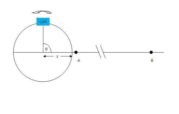

A car with a horn making a frequency of 'f' Hz is driven in a circle with a radius of 'r' m. The uniform velocity of the car is v ms-1.
Draw graphs showing the frequency observes by the observer who is standing on;
a) Position A
b) Position B
(Position B is very far from the circle)
f' = f([itex]\frac{u}{u\pm v}[/itex])
u - Velocity of sound
v - Velocity of the car
*Please refer the attachments*
My answer for this one is only the position A is having a variation in the frequency while the position B observes the same frequency of 'f' Hz
Am I Right or please help me with this one! :)

When at position B, is the car a constant distance from the observer? If not, it must be sometimes moving towards the observer and sometimes away.
I suggest you should show the position of the car on the horizontal axis of the graphs, e.g. in terms of theta, where the car's position is at (r, theta) in polar coordinates centred on the centre of the circle. The comparison between the two graphs is interesting.
Nope, both positions A & B are at constant distances and they're not moving either. So you mean both positions observe a variation in the frequency regardless how far they're from the source?
And is that graph I drew correct?

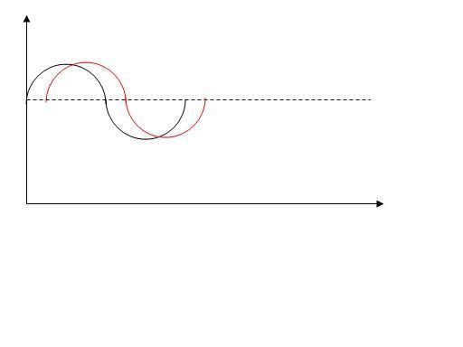

I've changed the graph accordingly. Is it correct now? :)

B is about right, but A is significantly off. At what theta will the car be traveling straight towards A?
Here's a question I missed before: The peak observed frequency will be when the car is moving straight towards the observer, right? Does the distance affect this?
So that means if I draw a tangent to the circle from the point B, that is the moment when the car is moving straight to the point and that's when the highest frequency is observed?
And another thing, Are these both positions observe the same highest frequency? Or is it differs?

Is this one the correct graph?

No, the shape is significantly different in the A case. Pls try to answer this question I keep asking you: at approx what values of theta will the frequency be highest and lowest at A? Remember, since the speed is constant, this depends entirely on the extent to which the motion is towards or away from A.
Draw two tangents to the circle from point A. One tangent represents the car coming in and the other one represents the car going out. That is when the highest and the lowest are observed. Theta values are -θ and +θ where theta is measured taking AO as the base.
Am I close enough?
I drew the graph accordingly.
Much better. My only quibble now is that the slope is too steep around θ = pi. It will be quite gradual there. The curve should be a bit more like a sawtooth.

Just to finish this off... if you take A as being on the circle then with a little geometry you can see that the speed away from the observer will vary as cos(θ/2) as θ runs from 0 to 2pi. Plot that and compare with your sketch.
Yea I'll try that too. Thanks again! :)
