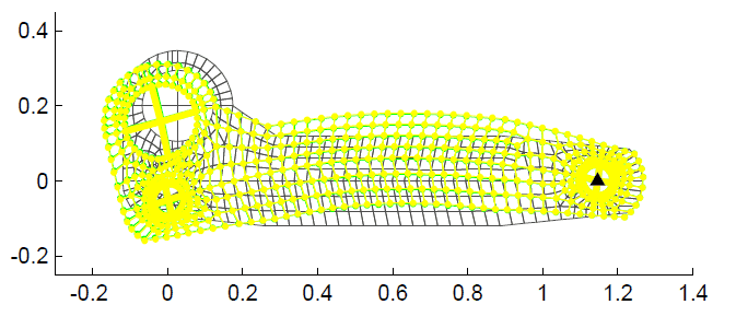

I would like to ask you a question about Component Mode Synthesis (CMS), which is the topic of my bachelor thesis. My primary resource is the classical AIAA article "Coupling of Substructures for Dynamic Analyses: an Overview" by Prof. Craig.
For now I am considering a simple mechanical system consisting of two connected bodies (arms) according to the first picture. The individual bodies have been modeled in ANSYS and their mass, stiffness, nodal coordinates and adjacency matrices were imported to Matlab, where reduction and interconnection themselves are carried out.

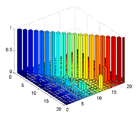

First the FEM solution without reduction (i.e. in physical coordinates) is calculated for reference and then two CMS methods are implemented, namely the Craig-Bampton's (fixed-interface normal modes & constraint modes) and Rubin's (free-interface normal modes, rigid-body modes & residual flexibility modes).
Now to my question, which might be a bit funny, bacause I am complaining about the methods being too precise. :) It seems that the natural frequencies of both methods correspond exactly (!) to the FEM solution, errors being of the order 0.01% which can be accounted to numerical round-offs. If I keep 30 natural modes for each body corresponding to 30 lowest frequencies, the first 50 natural frequencies of the connected system are exact! Then the error increases and the last calculated frequency (60th) has an error of 20% (talking about the Craig-Bampton now). I was really surprised by this, do you somebody have an insight where this "exact" corresponence comes from? If I compare the normal modes of the assembled reduced model with the reference solution by the Modal Assurance Criterion (MAC), I get the expected inaccuracies (please see 2nd included picture for the 20 lowest freq. normal shapes).

CMS works well when the interface between the components is "simple" compared with the dynamics of each component.
if you want a problem that doesn't work so well, try something like a square plate cut into two parts.
Or try a thin cylinder with diameter = length, fixed at one end. You could cut it into two cylinders (with different lengths, of you want), or two semicircular shells.
I see, so this very good result is in fact an exception caused by the problem being too simple. I was planning to consider a truss system as a second example, but in that case the interface would again consist of only several DOFs, so I will rather attempt one of your tips.
