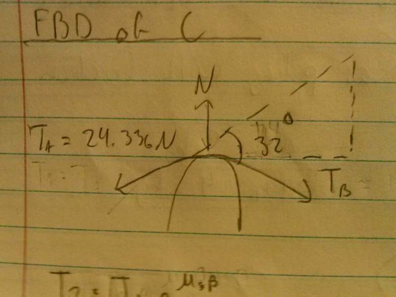

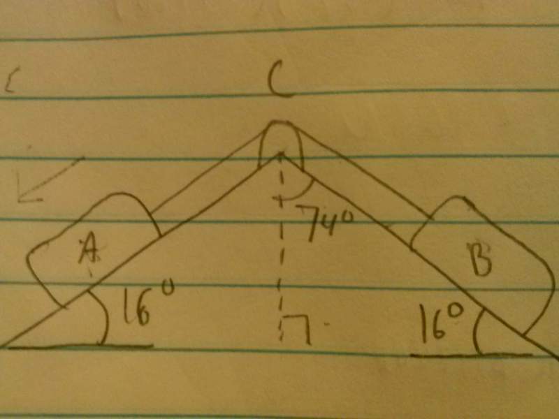

Blocks A and B are connected by a cable that passes over support C. Friction between the blocks and the inclined surfaces may be neglected. Knowing that motion of block B up the incline is impending when mB = 4.5 kg, determine:
(a) the coefficient of static friction between the rope and the support
(b) the largest value of mB for which equilibrium is maintained

My problem is that for part (b), my answer is wrong. I would like to know where I went wrong in my calculations. Thanks for the help in advance.
I found the forces working on Block A
ƩFx = 0
→ TA - WAsin(16) = 0
TA = 24.336 N
Then, Block B
ƩFx = 0
→ WBsin(16) - TB = 0
TB = 12.168 N
Then, I looked at support C where I found the angle to be 32°, and I used (1) to find the static friction.
β = (32)(∏/180) ≈ 0.559
TA = TBe^(μsβ)
24.336 N = (12.168 N)e^(μsβ)
e^(μsβ) = (24.336 N)/(12.168 N)
μsβ = ln [(24.336 N)/(12.168 N)]
μs = (1/0.559)*ln [(24.336 N)/(12.168 N)]
μs ≈ 1.240
Then, since I know TB has to be greater than itself to upset the equilibrium, I did
TB = TAe^(μsβ)
TB = (24.336 N)e^[(1.240)(0.559)]
TB ≈ 48.673 N
Then, to get the mass I divided the TB by g = 9.81
mB = (48.673)/(9.81) ≈ 4.962 kg
That is wrong.
You forgot that the mass isn't hanging straight down.
I just tried multiplying it by sin(16), which of course didn't work, but dividing by it sure did work. Thanks.
