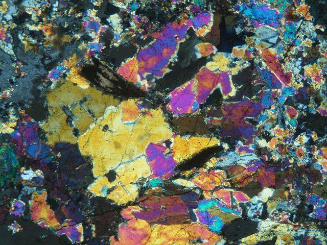

1) Is birefringence different in plastics, tempered glass and calcite crystal?
Yes I would expect it to be very different.
After all its different even between crystals of different minerals, say calcite, silia, mica
its one way to be able to distinguish different minerals when doing optical mineralogy ( Petrology)
here's an example of the mineral Epidote
using birefringence, exticntion angle etc, determination of individual minerals within the sample can be done
When I was doing my geology degree, this was one area I really enjoyed. Grinding thin sections of minerals on microscope slides. Then doing the analysis of them with the microscope.regards

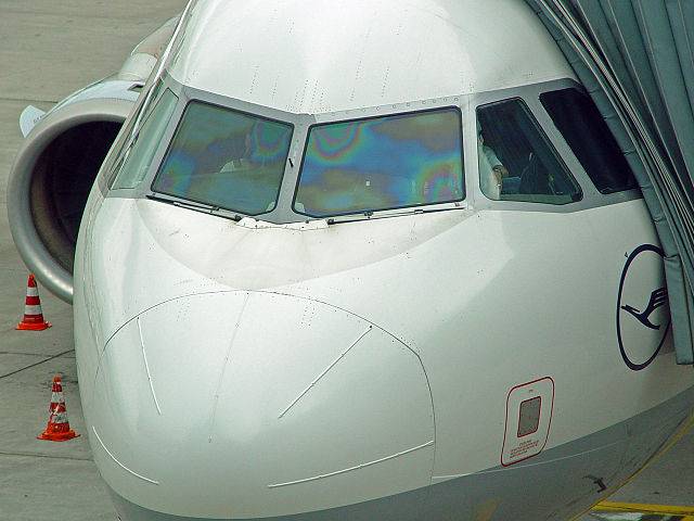

In Wikipedia, this photo of an Airbus cockpit window is used as an illustration of stress induced birefringence. The color contours are assumed to correspond to tension lines because the left and right window colors are mirror images. However, the photo was taken without a polarizing filter on the camera, so there is some doubt that birefringence is involved here. What else could explain these color contours?
The colors may be due to thin layer interference.
Maybe in the inner layer of polymer.
The tension in the window may change the thickness of the layer a little so the colors may indeed be a map of the stress. Only the mechanism is a little different.
A similar effect can be seen when you press together two microscope slides. The pattern of interference colors changes when you squeeze the "sandwich" with your fingers. But in this case there is just air between the slides. I don't know what is the airplane windshield structure but is very likely to be a multiple layer structure.
