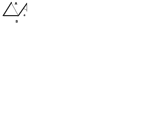

Three rods with length l and mass m are arranged like the figure in the attached file. There connections are without friction.
One rod is horizontal and the other two parallell and in the same plane.
An elastic string connects point A and B.
The tension in the string is proportional to its length.
Determine the equillibrium angle a and investigate the stability.
Any ideas on how to solve this problem?
Thank you.

Is the elastic coefficient k of the string also given as data in the problem?
only that
tension in the string = k * length of string
There must be something more to this. What is holding these rods together? Are they hinged? Is the system subject to gravity? Is some part of this apparatus being held in place so it cannot free fall?

Let's try this for starters
For equilibrium, neglect the thickness of the rods. Reference the zero of gravitational potential energy U to the top mount. Then
[tex]U = -2mg \l cos a[/tex]
The string is stretched to a length x given by the law of cosines
[tex]x^2 = \l^2 + \l^2 -2 \l^2cos(90 - a)[/tex]
[tex]x^2 = \l^2 + \l^2 -2 \l^2sina[/tex]
[tex]x^2 = 2 \l^2 (1 - sina)[/tex]
The potential energy of the string equals the lost gravitational potential energy
[tex]2mg \l cos a = \frac{1}{2}kx^2 = k \l^2 (1 - sina)[/tex]
[tex]\frac{1 - sina}{cos a} = \frac{2mg}{k \l}[/tex]

You are using an energy conservation approach. Remember that we don't know the initial height. Even if we did, we would only find the point at which the system will temporarily stop (still no equilibrium). What we are asked is to find the equilibrium angle.

JohanL. Use the equilibrium condition with forces that apply on the bottom rod.

You are quite right. So my erroneous calculation, if done correctly, should be the minimum angle if the system were released from rest with an angle of a = 90, assuming the elastic constant of the string is sufficient to keep the thing from going past vertical. That assumption is of course not justified- My bad.
Also another hint: the absence of friction at the hinges makes the reaction force of a hinge colinear with the rod to which it joins (see why). With this, it should be very easy to set up the equilibrium conditions for the horizontal and vertical directions and express the angle a in terms of m, l, and k.
Let me see if I can salvage a bit of dignity after making my earlier sophomoric error. An energy approach is valid if done correctly, so let's see if I can do it right. Again, referencing gravitational potential energy to zero at a = 90
The total potential energy combining gravity and the spring is the sum of the two
[tex]U_{total} = -2mg \l cos a + \frac{1}{2}kx^2[/tex]
[tex]U_{total} = -2mg \l cos a + k \l^2 (1 - sina)[/tex]
Equilibrium is at the minimum of the potential energy (not the zero, DOH! as Homer would say). The zero of the potential energy will give the limiting value for a. As I think more one it, there will be a limiting value somewhere, though it might well be at a negative angle between zero and 90.
[tex]\frac {dU_{total}}{da} = 2mg \l sin a + -k \l^2 cosa = 0[/tex]
[tex]2mg sin a = k \l cosa[/tex]
[tex]tan a = \frac{k \l}{2mg }[/tex]

Yeah, that's the right answer.
Thank you!
The answer for the stability is
stable if 0 < a < pi/2
unstable if pi < a < 3pi/2
And its unstable in that range because the potential energy don't have a minimum there.
