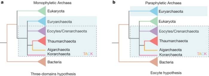

Most biology textbooks state that life can be classified into three domains: bacteria, eukarotes, and archaea. This classification began from early studies looking at the evolutionary relationship between these three groups of organisms that concluded that all archaea are more similar to themselves than to bacteria and eukaryotes, all eukaryotes are more similar to themselves than to bacteria or archaea, and all bacteria are more similar to themselves than to archaea or eukaryotes. These studies led to the phylogenetic tree shown in panel a below, which shows the evolutionary relationships between bacteria, eukaryotes (eukaryota), and the main branches of archaea (highlighted in blue):
(http://www.nature.com/nature/journal/v504/n7479/full/nature12779.html)
Inferring evolutionary relationships from billions of years ago, however, is a tricky business. The studies that led to these conclusions relied on some assumptions – for example that base compositions remain constant across different lineages and that evolutionary rates remain constant across the different DNA sequences being analyzed – that simplified the analysis, but were not necessarily correct. Newer methods that try to address these concerns are beginning to suggest a different evolutionary history that includes only two domains of life (see panel b above).
These studies suggest that all archaea are not more similar to themselves than to eukaryotes (for example, eukaryotes and eocytes are more similar to each other than eocytes to euryarchaeota). Thus, these studies conclude that eukaryotes are best classified within archaea rather than being a separate branch of the evolutionary tree.
In evolutionary terms, the three domain model hypothesized that the last common ancestor of all life first split into two different populations: bacteria and the archaea/eukaryote ancestor. The archaea/eukaryote ancestor then branched off into two populations, the archaea and eukaryotes giving the three domains of life. The newer model instead suggest that archaea and eukaryotes did not evolve in parallel. Rather, archaea evolved first and then the eukaryotes later evolved from an ancient archaeal lineage.
Of course, the art of constructing evolutionary relationships from extant sequencing data is by no means an easy process, so the question of a two or three domains tree of life is by no means settled. Newer methods or better analyses may certainly provide more clarity in the future. While this information has little practical implications for biology (other than better understanding how eukaryotes evolved), it's always interesting to see facts in textbooks being challenged by new data. For a more in depth discussion of the topic, see the following review article from this week's issue of Nature:
Williams et al. 2013. An archaeal origin of eukaryotes supports only two primary domains of life. Nature 504: 231. http://dx.doi.org/10.1038/nature12779[/URL]

Yes, that's an accurate view of what the evidence shows. According to the two domain model, some archaea acquired mitochondria through endosymbiosis and gave rise to the ancestor to all eukaryotes. Because membrane-enclosed organelles are a defining feature of eukaryotes (and these arose thorough endosymbiosis), eukaryotes probably could not have split off from archaea prior to the endosymbiosis occurring.
What's in question with the two-domain vs three-domain model is when the endosymbiotic event leading to the origin of eukaryotes took place. If this event took place very early in the evolution of archaea (before they diversified into different kingdoms), then the three domain model is correct. If eukaryotes evolved much later after diversification of the archaea and descended from a specific branch of the archaeal tree, the two domain model is more correct.

Actually, the main difference seems to be the placement of the eukaroytic branch between the 3 domains and eocyte proposals. But even in the 3 domains hypothesis, archaea and eukaryotes are don't seem obviously equal as domains to bacteria - naively, wouldn't the common ancestor to archaea and bacteria be more equivalent to bacteria as a domain (assuming the 3 domains tree)? If so, what is the raesoning for 3 domains in if one assumes the "3 domains" tree, instead of 2 domains?
Also, if I understand correctly, the main advance in the discovery of archaea was that prokaryotes were done away with and split into bacteria and archaea - that seems to still hold?

The three domain tree gives three domains because each of bacteria, archaea, and eukaryota form mutually exclusive monophyletic groups. That is, all species in that group descend from a common ancestor and the group includes all descendents of that common ancestor. The two domain tree does not support eukaryota as a separate domain from archaea because archaea would not form a monophyletic group if you excluded eukarya from the group. Again, this has little practical implications for most biologists but it does change the number of domains we can define because of the rules of taxonomy and systematics.
The discovery of archaea did something similar. Previously, life was classified into five kingdoms (monera, protista, animalia, plantae, and fungi) with all prokaryotes falling into kingdom monera. The discovery of archaea, prokaryotes that were more closely related to eukaryotes than to bacteria, revealed that monera was no longer a monophyletic group. Thus, biologists (led by Woese) reclassified life into (what they thought at the time) three new monophyletic groupings (bacteria, archaea, and eukarya) which they termed domains.
Of course, given the extensive amount of horizontal gene transfer in evolution, it's not even clear that a classical phylogenetic tree best represents some of these early evolutionary events. Eukaroyotes clearly arose by combining genes from archaea and bacteria, but typical phylogenetic trees have no way of representing that evolutionary history.

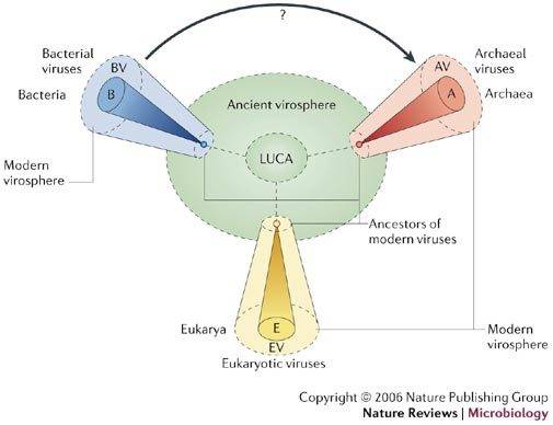

There has been some buzz over the last couple of years about a possible forth domain of life, composed of mega viruses. I don't know how it will all pan out, but it's certainly intriguing!
Giant viruses open Pandora's box (Nature News blurb with links to published research.)
NatureNews said:
But these viruses, described today in Science1, are more than mere record-breakers — they also hint at unknown parts of the tree of life. Just 7% of their genes match those in existing databases...The researchers are now trying to determine the viruses’ origins by characterizing the unknown genes and the proteins they encode. They have long suspected that giant viruses evolved from cells; if they are right, the ancestors of Pandoraviruses must have been very different from the bacteria, archaea and eukaryotes we have today. “We think that at some point, the dynasty on Earth was much bigger than those three domains,†says Abergel. Some cells gave rise to modern life, and others survived by parasitizing them and evolving into viruses.
Pandoraviruses: Amoeba Viruses with Genomes Up to 2.5 Mb Reaching That of Parasitic Eukaryotes.
Genomics of Megavirus and the elusive fourth domain of Life
I think it's safe to say that the future of such genomic analyses will reveal more than a couple surprises we can't even see coming!
Wow, ok, considering viruses as a domain of life made me interested in the origin of viruses, for anyone interested:
http://www.nature.com/scitable/topicpage/the-origins-of-viruses-14398218
From this comes an interesting suggestion that the eukaryote nucleus could have once been a virus:
"Others have argued that precursors of today's NCLDVs led to the emergence of eukaryotic cells. Villarreal and DeFilippis (2000) and Bell (2001) described models explaining this proposal. Perhaps, both groups postulate, the current nucleus in eukaryotic cells arose from an endosymbiotic-like event in which a complex, enveloped DNA virus became a permanent resident of an emerging eukaryotic cell."

Wow, ok, considering viruses as a domain of life made me interested in the origin of viruses, for anyone interested...
Thanks for that. I remember spending a few days on a similar path when I was learning about the mega viruses too. :cool: IMHO, the most interesting of the three possibilities given for virus origins (and the one relevant to the thread at hand):
