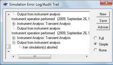

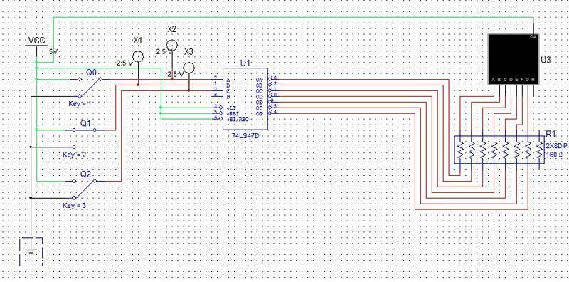

I'm having the same problem here, can anybody help? It is an common anode. I tried putting probe at the outputs of they decade counter and they light up all right. But the seven segment desplay just wouldn't light up!
The 7447 is a decoder which turns Binary Coded Decimal to 7 segment output.
If an output is low, it will sink current from a LED of the display. So, if you are seeing all high outputs, then the LEDs will be turned off.
The 7447 has a lamp test feature. You connect the "LT" pin (pin 3) to ground and all outputs (QA to QG) should go low and turn on all segments of the display.

Thanks for the tip...I grounded the LT pin but the outputs were still HIGH.
The diagram doesn't show power (5 volts) on pin 16 or ground on pin 8. Are these really connected?
yeah...here in multisim the pins are not shown and there is no need to connect them since they are already connected by default, I think. I've experimented with other IC and there is no problem.

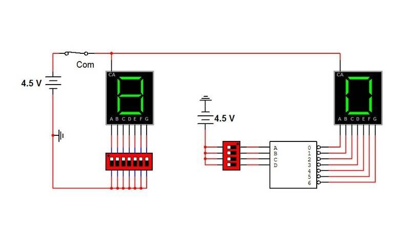

I home school my 12 year old son. We do an electronic lab every week.
This is a working Binary into a 7-segment display EWB circuit.
I build this circuit for my son to simulate and to create a truth table.
Let me know how it works out for you:
Jack
