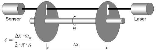

In theory a one-way measurement of the speed of light would be possible with two parallel slits rotating on the same axis. But in praxis it would be difficult to get the required accuracy.
I don't understand your measurement but I can assure you that it's not an issue of accuracy. There is always some assumption that is made in these kinds of proposals that is tantamount to saying that the light takes the same amount of time to go one way as it takes to go the other way.

I mean something like this:
The distance between the slits can be measured by use of any suitable reference.
The orientation of the slits would be adjusted in rest. After starting rotation any oscillations need to fade out before the measurements starts. Than the angular velocity can be measured locally at any point of the axis.
The maximum sensor signal is reached after n full rotations of the slits. The speed of light results from the corresponding angular velocity and the distance between the slits.
As it is a one-way measurement there is no other way. Therefore no corresponding assumptions are required.
Yes there is. DrGreg already addressed it. You have an assumption of rigidity.
There is no rigidity required. Elasticity is sufficient.
That doesn't matter. The "experiment" still overtly requires the use of clock synchronization so you're back to square one. If you have a journal reference attempting to bypass the use of clock synchronization in any and all "measurements" of the one-way speed of light then please link it.
If your shaft is elastic, then from where does you confidence come that the two slits pass the light at the same time?
How do you measure ##n##?
The slits can not pass the light at the same time because the light needs some time to travel from one slit to the other.
Your picture shows that light is passing through both slits at the same time. Of course it's not the same photons passing through both slits at the same time. I thought the idea was that a photon passing through the first slit while it was on the top would pass through the second slit exactly one rotation later while it was on top and you vary the speed of rotation until you see light come through. Isn't that what is supposed to happen? And unless you assume that both slits are on top at the same time, in other words, that the shaft is rigid, then how can you determine when a given photon got from the first slit to the second slit?
DrStupid said:
The experiment results in a sensor signal as a function of the corresponding angular momentum.
You mean angular velocity, correct? That's what you're measuring, according to your description. I'll assume that's what you mean below.
DrStupid said:
This function is periodic and n is "measured" by counting the maximums: n=0 for the first maximum for the non rotating slits (obviously not very useful), n=1 for the second maximum and so on.
Ok, so the experimental results will be a curve of sensor signal vs. angular velocity. But the angular velocity that appears in the experimental results is measured at some particular point on the axis; there is no guarantee, without an assumption of rigidity, that the angular velocity at the point of measurement equals the angular velocity of the slits, because the whole assembly is elastic.
Even if you let all oscillations damp out as best you can, there is no guarantee, again without an assumption of rigidity, that the relative orientation of the slits under steady rotation is the same as it was in the original rest state. And if you try to measure angular velocity at multiple points, or try to measure the actual relative orientation of the slits while in motion, or try to drive the shaft at multiple points to control the slits' relative orientation (as ghwellsjr pointed out), you have the usual clock synchronization issues.
Finally, you have an obvious clock synchronization issue between the sensor and the measurement point for angular velocity; these two measurements are at spatially separated points, so you can't just assume the two signals are referenced to the same time, which means you can't even generate the experimental result you are describing without making some assumption about clock synchronization.
Yes, you are right.
The angular velocity is not the problem. It could be measured by Doppler effect. The problem is the same orientation of the slits in their co-rotating rest frame. This is guaranteed because the assembly is elastic. Elasticity implies that the device returns to its position of rest after the accelerating angular momentum is removed. It might start oscillating first but after thermalization of the mechanic energy the slits will be in their original relative position again.
If the construction is sufficiently balanced I do not see why there should be a torsion without angular momentum. However, if such a torsion exists and leads to a wrong result it should be detectable because it would hardly give the same wrong result for any configuration.
These measurements neither needs to be performed at spatially separated points nor at the same time. Thus I do not see any clock synchronization issue.
As mentioned above the shaft does not need to be rigid. Elasticity is sufficient to guarantee that the slits are in their original relative orientation as soon as the rest position is reached.
Do you accept without question or exception all the tenets of Special Relativity, including the Lorentz Transformation?
Which requires some assumption about light propagation in order to convert the Doppler measurement to an angular velocity. See further comments below.
Which requires the assumption that there *is* a co-rotating rest frame. There is no guarantee that there is one without an assumption of rigidity.
It means no such thing. The implicit definition of "elastic" that you are using here, which is basically that the inter-atomic distances obey Hooke's Law, is a non-relativistic approximation; it does not, and cannot, hold for a fully relativistic system.
"Sufficiently" has to mean "perfectly" here, which is not possible. Any imbalance will result in the slits not being aligned in the steady rotating state even if they are aligned in the original rest state. So perfect balance is a necessary condition for the slits to be aligned in the steady rotating state; however, it is *not* a sufficient condition. See below.
Um, first of all, in the steady-state rotating case, there *is* angular momentum. The only state with zero angular momentum is the original rest state, before the assembly is spun up.
Second, even if there is no torsion in the steady rotating state, after the disks are spun up and oscillations are allowed to die away, and even if the assembly is perfectly balanced, there is still no guarantee that the slits will be aligned, assuming they were in the original rest state. That's because there is no way to spin up *any* object from rest to a constant angular velocity without changing the relative orientation of at least some of its parts. And unless you precisely control the spin-up process for every single atom of the assembly, you cannot control how the relative orientations of the parts change, even assuming perfect balance to start with.
The wrong result wouldn't be a matter of torsion; as above, there doesn't need to be torsion present for the slits to be misaligned in the steady rotating state. The misalignment just leads to an error in the relationship between measured angular velocity and measured sensor signal.
Um, what? Your diagram explicitly shows the sensor, where the sensor measurements are taken, being spatially separated from the axis of the assembly, where the angular velocity measurements are taken. So something has to propagate in order to make the comparison: either a signal (e.g., a Doppler signal, as you suggested) has to propagate from the axis to the sensor (where, say, a Doppler shift measuring device is co-located with the device that senses the laser signal), or a signal from the sensor has to propagate to where the angular velocity of the axis is measured. And any such propagation requires assumptions about how much time it takes, i.e., assumptions about clock synchronization.
Yes, they do. Your experimental result is a graph of sensor signal vs. angular velocity. How can you match the two measurements up without a common time reference?
Doppler is just one possibility. The angular velocity can be measured locally as well. If the records for both slits show the same constant value than they are rotating with the same speed.
I do not see where rigidity comes into play here. Please explain.
Please explain how relativistic effects would lead to a torsion.
No. It means that the assembly remains radial symmetric within the accuracy of measurement. Radial deformations can easily be detected by an external reference.
