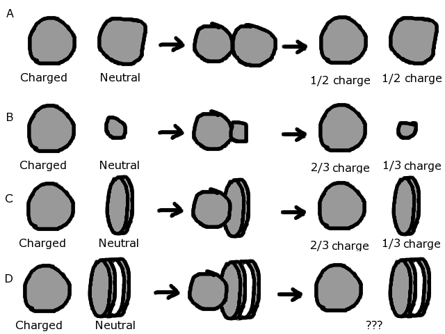

Here is a better description of my main question. See attached image.
In case A, a metal sphere is charged up and brought in contact with another, neutral, identical sphere. The excess charge redistributes itself so that each sphere now has 1/2 the excess charge, right?
In B, the neutral sphere is now 1/2 the mass/volume/whichever is important here. This time only 1/3 of the charge is distributed to the smaller sphere, because there is "less room" for it to fit.
In C, the exact same thing as B, except the smaller sphere has been hammered out into a thin plate. The physical shape of the second object has no effect on how much charge will be transferred, does it? Edit: I think this is wrong. The charges are trying to get as far apart as possible, so a very thin very wide sheet would collect more of the charges than a sphere of the same mass/volume.
In D, the same exact plate as B, except now a thin insulating plate has been stuck to the metal plate, and another conductive plate placed very close. How much charge gets transferred to the plate now??
You are correct to think you were wrong. (Make sense?) The capacitance of an object depends upon its shape.
You can calculate the capacitance of the new plate. It does depend upon the dielectric between the plates, so the amount of transferred charge is different. But there is also another thing. The added plate is isolated, so has no way to develop a net charge. Nevertheless, it does have a non-neutral charge distribution. Think of the added plate as 2 surfaces: the surface facing the first plate and the surface facing away. If there is charge Q on the old plate, then there is charge -Q on the surface of the new plate facing this old plate, and charge +Q on the surface of the new plate facing away from the old plate.
THAT is what I was wondering! The amount is larger, correct?
Is the Q charge on the "old plate" uniformly distributed? Or is it all "gathered around" the dielectric, with a neutral charge at the end of the lead?
