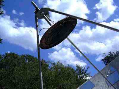

back in '92 I converted a 12 foot dish using 1 foot square mirror tiles
by attaching the mirrors with two drywall screws at each corner the dish's curve produces a focal point roughly where the lnb was
if memory serves there was room for 112 tiles w/o overlapping mirrors
don't know what the exact concentration ratio was but it worked great for igniting wood, flash boiling water or melting lead
(if you have access to scraps from a glass shop hexagonal or triangular tiles could provide better coverage with smaller gaps)
*fiddlesticks, thought there were more pics but these were all I could find
