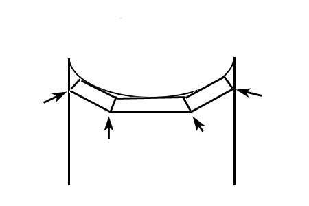

Why not just start out with slightly oversized boards, fit the first one, cut the edge at an angle, match the angle on the second board to butt the two ends together, then do the same for the third board? Actually, just for convenience, I'd start with the two ends first, then just bring the center board in, set it up on the first two and draw a pencil line of where you need to cut just by tracing the underside. I'll try to draw a sketch of what I mean...I'll come back and edit in an attachment if I'm successful.
Okay, I'm adding an attachment. Then all you need to do to determine the length of the boards needed is get out your handy dandy ruler and measure straight lines between each of the arrows I've drawn in the picture. This also means you won't have gaps between the shelves, making them more useful and attractive.

I was assuming he just didn't want to cut curves, not that he didn't want to do any cutting, but I could be wrong. If he just wants to buy pre-cut shelving and not mess around with any mitered cuts, then the lengths need to be determined on the wall side by finding the "pivot" points on the wall he wants to use and then measure the length of the three lines tangent to those three points. I honestly would just do it the practical way of buying boards a little longer than you're going to need, mount the brackets for the center points, rest your shelving boards on the brackets and use pencil lines to mark where to make your cuts. It's a shelf in a closet, so you don't need to have the angles perfect, just cut them so the two boards butt into each other at whatever angle looks good to you. Even if in the end you wind up with some small gaps between them, it'll be better than leaving the edges square with large gaps between them.
