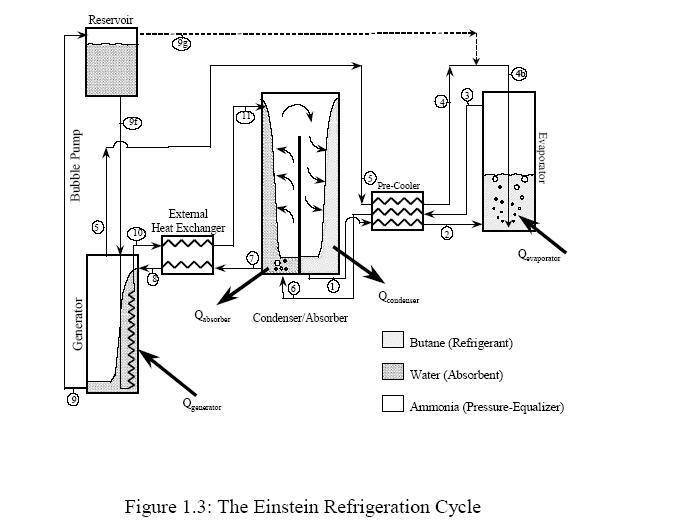

The Einstein cycle

Does anyone know if Einstein used a bubble pump ??
Being more of an electonic type guy , and the fact that water is a magnetic dipole molecule. i am wondering wether or not you could help the process along by using electro-magnetic induction ( a coil of wire wrapped around the tube), in place of the bubble pump...

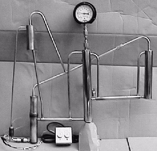

how difficult do you thing it would be to construct a working model of the Einstein referigerator.?
this doesn't look that difficult..
