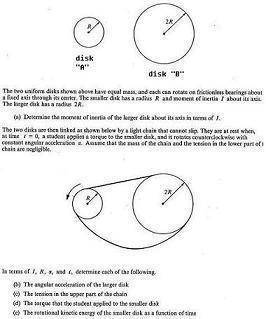

Hi, thank you so much for making this kind of post for students like me. I have tried the quesotins but i want to make sure that i was right. if worng, please correct me.
THANK YOU SO MUCH. Also i had attached pictures of the question to give you enough information. PLEASE REFER TO THE PICTURE ATTACHED.
Q) The two uniform disks shown above have equal mass, and each can rotate on frictionless bearings about a fixed axis through its center. The smaller disk has a radius R and moment of inertia I about its axis.
(a) determine the moment of inertia of the larger disk about tis axis in terms of I.
-> I used the equation Inertia = mass*radius to solve this question,
Let's say that smaller disk has a subscript "A" and larger; "B".
Then, I(B) = m(2R) = mR(2).
since mR is equal to I, we have I(B) = I*2 = 2I
so the answer is 2*I. Am I right?
The two disks are then linked as shown below by a light chain that cannot slip. They are at rest when, at time t = 0, a student applies a torque to the smaller disk, and it rotates counterclockwise with constant angular acceleration alpha. Assume that the mass of the chain and the tension in the lower part of the chain are negligible.
In terms of I, R, alpha and t, determine each of the following.
(b) The angular acceleration of the larger disk (alpha(B))
-> torque(A) = I*alpha
torque(B) = 2I*alpha(B)
torque(A) = torque(B) <- IS IT POSSIBLE THAT I ASSUME THIS?
I*alpha = 2I*alpha(B)
alpha(B) = alpha / 2. <- AM I RIGHT?
(c) The tension in the upper part of the chain
T(Tension) = (I*alpha) / R.
T(A) = (I*alpha) / R
T(B) = (2I)(alpha(B)) / (2R) = (2I*alpha/2) / R = (I*(alpha) / (2R)
TO FIND TENSION, DO I SUBTRACT THE SMALLER ONE FROM LARGER ONE??
IF I DO, I GET:
T(A) = T(B) = (I*alpha) / R - (I*alpha) / (2R) = (I*alpha) / (2R)
Therefore, the tension in the upper part of the chain equals to (I*(alpha) / (2R).
(d) The torque that the student applied to the smaller disk
torque(A) = I*alpha <- I found this equation in my physics book. Is right? I kind of doubt it though. Please help me.
(e) The rotational kinetic energy of the smaller disk as a function of time
RKE = (1/2)*I*w^2 (omega)
to find an equation of w(omega) in terms of t and alpha, we take antiderivative of the equation alpha = (dw)/(dt), then we get:
alpha*t = w
IF we substitute alpha*t for w(omega) in the equation RKE = (1/2)*I*w^2 (omega), we get
RKE = (1/2)I*(alpha*t)^2.
So that is the answer.
So please correct me and thank you so much. Have a wonderful day, people!

in the first picture for question part (a) only, there are two regular circles. circle A has a radius of R and circle B has a radius 2R. They have the same mass and are indeendent of each other.
in the second picture which will be used from part (b) to (e), the two circles described in the first picture are in a chain. the circle B on the right and Circle A on the left. the chain moves from left to right and the tension on the bottom part at first is zero.
i hope this helps to solve the question.
Thank you!

First things first: What's the moment of inertia of a disk about a central axis? It's I = 1/2 M R2
Redo the first part, then we'll continue.

Forget about torques for this part. &alpha;A is a given. What's the relationship between &alpha;A and &alpha;B? Hint: the two disks are tied by a chain. What does that mean?
Also, no, you cannot assume that the torque is the same on both disks! Think about it. DiskA has two forces acting on it: the force applied by the student in giving his torque, and the tension in the chain pulling the other way. DiskB has only a single force on it.

The way to solve c & d is to write down the torque equations for both disks and solve the two equations together.
Torquenet=I&alpha;, for each disk. (You'll need the results from parts b and a.)

Yes. Now put it in terms of IA= I;
IB= 4*(1/2MR2)= 4I
(b) Since the disks are connected by a chain, they have the same angular acceleration. Thus the angular acceleration of the larger disk is equal to just ¥áA, which is given in the problem.
No, they have the same tangential acceleration, not angular acceleration. Think about it: the same length of chain must pass along each disk. Imagine the disk B was 1000 times bigger than disk A: the same bit of chain that turns A half way around would barely budge disk B.

Write out the torque equations for each disk. Tension is force; TensionXradius is the torque exerted by the tension.

You messed up the algebra above: &alpha;B= &alpha;/2
OK, OK, you've suffered enough...
The torque equation for Disk B:
FTRB = IB &alpha;B
Which, when we use the results of a & b, becomes:
FT = I&alpha;/R(That's the answer to part C!)
The torque equation for Disk A:
&Tau;-FTR = I &alpha; (where FT is the tension; &Tau; is the the applied torque)
Now we can solve for &Tau; (using the answer from part C)
&Tau; = 2I&alpha; (That's the answer to part D.)
Make sense? Go over this until you understand it. (And you'd better check my algebra.)
