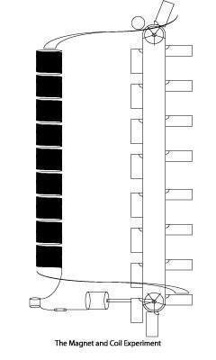

see, what I am picturing is not one magnet but lots of magnets on a conveyor/pully system driven by the motor. so all you have to do is generate enough energy to raise one magnet a few inches each time. When it gets to the top it falls down the coil and generates enough for the next magnet to be dropped. so you need to only generate enough electricity to spin the motor and gears enough to rotate the pully 'one notch'. I think using this technique I can keep the scale down. Of course, there wouldn't be any excess electricity which makes it more of a novelty than an ample source of energy, at least at first.

sorry its been a while since my last post but I've been away on business for the last 3 weeks... I've attached a mock up of what I was thinking for this concept. I was wondering, with the coil, would it be more effective to have multiple coils or one big coil. The research I've done so far seems to point to multiple coils being more effective. As always any thoughts on the subject are much appreciated.

Yes Maxwell's equations describe exactly what your asking about.
Let's tho look at your example (in RE maxwell), You could pull an infinitely long wire thru a circular magnet and measure a induced charge ( with a measuring device placed strategically along the infinite length). Conversely You could drag a magnet down the infinite length of a wire and see the same induced current.The eureka moment is to recognize that a torus is an infinite line with no beginning and no end and a coil is just a wrapped up long length of wire , that is why we don't have 2 mile linear reciprocating generators bulging from automobile hoods.
