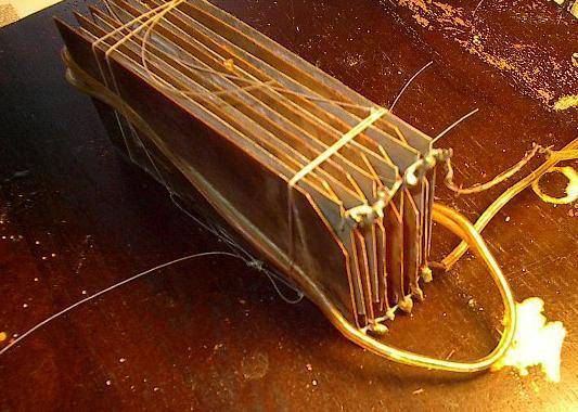

last night i tried to get hydrogen from water using the apparatus shown.
i have to improve my collection tecnique but i was able to collect about a third of a cup ful ..
say i collect it from the top of a dome shape device .
my question is how will i mix it with the oxygen , to burn it

I can't really tell what I'm looking at there, but if you are doing electrolysis, you are getting oxygen. Since water has both hydrogen and oxygen, splitting it up liberates both (one at the cathode, one at the anode).
Thanks for the reply ,
iwas wondering wether or not the gas would be mixed , or would it be mostly hydrogen at the top , of the collector?
The hydrogen bubbles up from the cathode and oxygen at the anode. The cathode is negatively charged (connected to the minus side of the battery) and the anode is positively charged (connected to the positive side of the battery).
Examine your apparatus and determine which is the anode and which is the cathode. The bubbles that form on those plates are as described above. If those bubbles mix above the water, then you'll have a mixture of oxygen and hydrogen. If you separate them, you will have hydrogen on the one side and oxygen on the other.
Hope that helps.
In its current configuration , i was putting 4.09 V at 2 A into the device..
which is a calculated 2 Ohms ( approx)..
it actually started bubbling at less voltage and current..
thanks for the reply

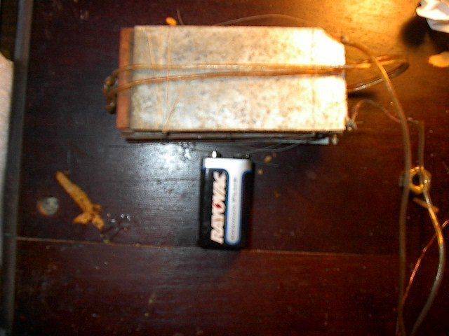

Edit : pic 2 ; Is a set of 12 plates alternating copper and zinc , separated by little pieces of insulators .. top front is the solder connection to the zinc plates ( zinc coated steel)..
bottom front is the connection to the copper plates..
that loop of wire in the very front is just a handle and has no electrical connections

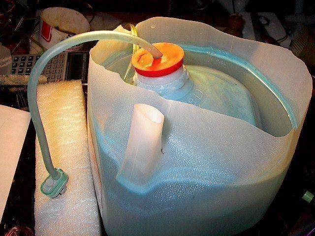

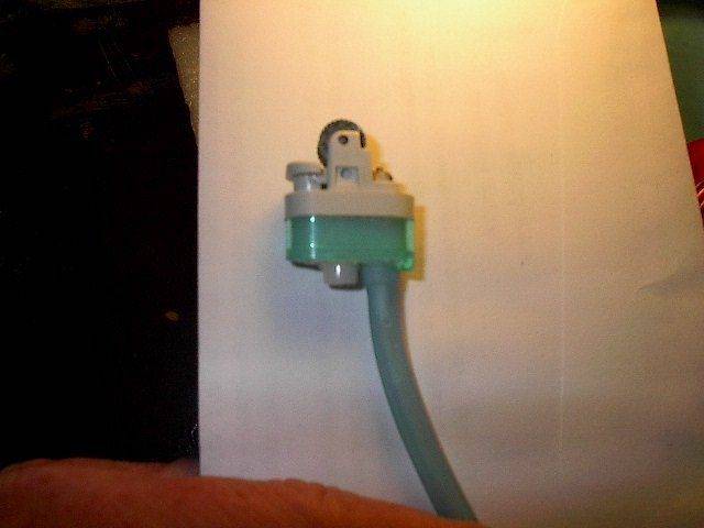

Ok I've improved the collecter
That H2 , O2 Flame is colorless isn't it ??
It lights with a little pop ..
I wasnt sure it was lit , till i burnt my finger with it..:bugeye: :wink:

[tex]2H_{2}O \Rightarrow H_2 + 2O_2[/tex]
For safe storage of [itex]H_2[/itex] you might want to collect it separately from the [itex]O_2[/itex].
