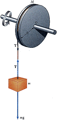

I can't for the life of me figure out what I'm doing wrong here. Here's the problem:
A 5.40 kg counterweight is attached to a light cord, which is wound around a spool (refer to Fig. 10.20). The spool is a uniform solid cylinder of radius 7.00 cm and mass 2.00 kg.
Ok... the first question is:
What is the net torque on the system about the point O?
Here's my take on the situation... the only torque being applied to the system is from the tension T of the string.
T = tension of string
m = mass of counterweight
a = acceleration of counterweight
R = radius of wheel in meters
M = mass of pulley
[tex]T - mg = -ma[/tex]
[tex]T = m(g - a)[/tex]
[tex] \begin{equation*}<br /> \begin{split}<br /> \sum\tau &= TR \\<br /> &= mR(g - a)<br /> \end{split}<br /> \end{equation*}[/tex]
Also...
[tex] \begin{equation*}<br /> \begin{split}<br /> \tau &= I\alpha\\<br /> TR &= \frac{1}{2}MR^2\alpha\\<br /> \alpha &= \frac{2T}{MR}<br /> \end{split}<br /> \end{equation*}[/tex]
Now we know that:
[tex] \begin{equation*}<br /> \begin{split}<br /> a &= R\alpha\\<br /> <br /> a &= R(\frac{2T}{MR}) \\<br /> a &= \frac{2T}{M}<br /> <br /> \end{split}<br /> \end{equation*}[/tex]
So...
[tex] \begin{equation*}<br /> \begin{split}<br /> T &= m(g - \frac{2T}{M})\\<br /> T &= mg(\frac{M}{M + 2m})<br /> \end{split}<br /> \end{equation*}[/tex]
So am I right in saying that the net torque on the system is
[tex]\tau_{net} = [mg(\frac{M}{M + 2m})]R[/tex]

That depends on what you mean by "the system". You calculated (perfectly, as far as I can see) the net torque on the disk.
If the question really was find the net torque on "the system" (meaning mass plus disk), then no. (That's a bit of a trick question.)

Here's a hint: the only forces that can contribute to the net torque on the total system are external forces.

Yes, the only (unbalanced) external force is mg; what torque does that force exert about the axis?

Yes, but what's important is: does the force exert a torque about the axis?
The weight of the disk (and the force that holds it up) act right through the axis. So they exert no torque.
But the weight of the mass (mg) does exert a torque (about O) = mgR !

Oh of course! Because the counterweight is connected to the pulley, it transfers the force exterted on it due to gravity into a torque about the axis.
I see it now. Thanks for your help!

Careful about thinking about anything "transfering" because it's connected to the pulley. If I cut the rope, the torque about 0 is still mgR ! (by definition of torque) No, you're not going crazy.
Just for fun: Treating the system as a whole, find the acceleration of the mass. Like this:
Torquenet = mgR = Inet&alpha;
Then compare to the answer you get using your original method of treating each body (mass, disk) separately.

Here's the second part of the problem:
When the counterweight has a speed v, the pulley has an angular speed &omega; = v/R. Determine the total angular momentum of the system about O.

You know the angular momentum of the disk. For the angular momentum of the mass, go back to the basic definition:
Angular momentum = R x Linear Momentum x Sin&theta; (look familiar?)
Make sense? It's a bit strange to talk of the angular momentum of something going straight, but you certainly can do it!
The total angular momentum of the system is the sum of the angular momenta of the parts.
