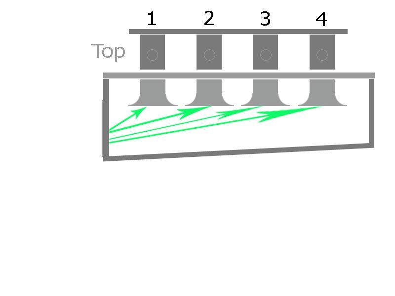

My concern is that where the closest intake is to the inlet is cylinder No.1 and the furthest away is cylinder No.4, the inlet stroke is the same for all 4 cylinders, yet from the point of the inlet to each cylinder the air has effectively different flow lengths to each cylinder.
The plenums you can buy, have a taper towards the Np.4 cylinder so as to reduce the volume and I am guessing increasing the velocity so as to arrive at the cylinder the same as the other cylinders.
But what is the calculation to work out the space required and the taper?

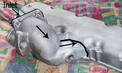

1. Attachment 1:
This is the plenum chamber as standard. As you'll be able to see no doubt is the airflow coming in has to turn through a tight elbow, and this elbow is very restictive.
2. Attachment 2:
This is a simple schematic of the plenum, the rectangular box shows where the airflow enters from the elbow. You'll notice it is considerably smaller than the inlet.

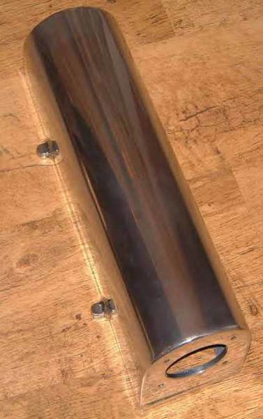

3. Attachment 3:
This is how the expensive and much improved plenum is designed.
You'll notice the airflow is direct from one end, and that the chamber itself is tapered to the rear where No.4 inlet is furthest away

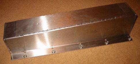

No.1 is an expensive one to buy
No.2 is a Homemade one (and worked extremely well)
No.3 is also an expensive one to buy.
Ive known of several people who have made them themselves, and to be honest i doubt they even bothered doing any calculations when designing it, however, if its not beyond my capabilities i'd prefer to go with Physics and Maths designing it for me :-)

I'll assume you're going with the tapered plenum design shown in attachment 3 above. I'd suggest that the plenum shouldn't introduce any additional pressure drop, the difference in pressure between each of the inlets should be zero. To do that, the plenum ID has to be as large as possible. At the very least, the ID of the plenum inlet must be more than the total outlet area (area of the 4 inlets added together). Also, the plenum can be tapered as shown, but I'd suggest making sure the cross sectional area at each location is significantly larger than where the air must eventually go. So at the half way point where the air has passed two inlets already, the cross sectional area of the plenum must still be much larger than the area of the two remaining inlets. I might suggest it being at least 50% larger in area, preferably more to reduce pressure loss.
To test your plenum, you might try drilling a very small hole in each of the four air inlets that could later be plugged say with a pipe thread plug. The smaller the better. They go down to 1/16" if I'm not mistaken, though that's pretty rare. Then simply put a pressure gage on each air intake to determine if they are the same. If not, porting the ones with lower pressure to make larger ports might help.
I also noticed in those pictures, the inlets were protruding into the plenum which is probably not the most efficient. Looking at restrictions to flow, such a design is generally going to have more restriction than one where the inlet ends at the plenum wall (ie: it goes between the engine inlet valve and plenum wall). What it looks as if is being done to reduce that restriction is to have a funnel type inlet, which should help significantly. I think the best design would be to have that funnel shape and also start the inlet at the wall of the plenum as opposed to sticking it into the middle of the plenum. Also, the funnel shape might best be made in the shape of a nozzle inlet such as used for venturies. Imagine a donut in which the ID of the donut is equal to the ID of a pipe. Now imagine the donut being stuck to the end of the pipe so you have a rounded inlet. That's about the best shape you can have to reduce restriction, and better for example than a conical shape.
