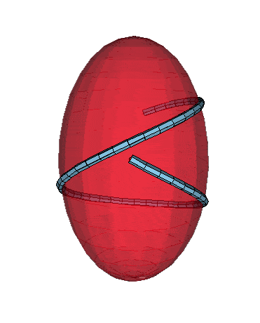

snoopies622 said:
In this thread I'm reading that between two points there may be not only more than one geodesic, but each with its own length. And for now that thought makes my head hurt, but I suppose I'll get used to it :wink:.
It's not that strange really. Imagine an ellipsoid instead of a sphere. Suppose that you are at one of the points on the ellipsoid where the curvature is the minimum and you want to follow a geodesic to the opposite side. Now there's a whole interval of possible path lengths. Of course, when I try to picture a time dimension my head starts to hurt too.
kev said:
What if we take the idea that the initial velocity as a vector uniquely defines the geodisec?
Yes, I think this is the key element. Talking about the shortest possible path in regards to geodesics only confuses people. It's better to talk about a locally straight path. Like adhesive tape sticked to a curved surface without any folds on the tape's edges, The initial direction of taping fully defines the further path.
Are you saying that if we take the ellipsoid
(\frac {x^2}{4})+y^2+z^2=1
and want to travel along its surface from (0,1,0) to (0,-1,0), then not only is one of the semi-circles contained in the plane x=0 a geodesic, but so are the (slightly longer) paths adjacent to it? That would make a geodesic not even a local minimum.
