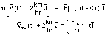

The right-side-integration implies the magnitude of the towing force might vary over the duration of towing in any number of ways. Put otherwise, there is no single solution for "towing force" that will get the job done. The extra information needed is that the tow force is constant and it acts 90° to the drift.
Equation (8): m [V(t) + 2 (km/hr) J] = |F|_tow (t − 0+) I; V_slab(t) + 2 (km/hr) J = (|F|_tow / m) t I
(8) The Mean Value Theorem (MVT) will transform the integral right-of-equality
to the average force times the duration of its action.

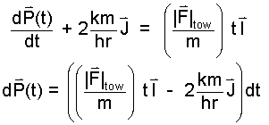

The integration above yields the velocity of the slab. The constant tow force cannot be obtained. to proceed, we are use the fact, V(t), equals dP(t)/dt. We make that substitution and to move on, we separate variables and apply limits in the same style as before. Please do the algebra to confirm the correctness of the following equation:
Equation (9): dP(t)/dt + 2 (km/hr) J = (|F|_tow / m) t I; dP(t) = ((|F|_tow / m) t I − 2 (km/hr) J) dt
(9) A number of steps were required to arrive here.
Please check the changes.
The limits of the integral left-of-equality are vector positions. The slab is initially directly upstream of the rig a distance of 20,000 m. The rig is at the origin hence the lower limit of the integral is 20,000 m J. The final or safe position of the slab is 400 meters directly abreast of the rig. The lower limit is 400 m I. Also, the integrand ahead of dP is "1." The integration of an exact differential equals its "upper limit minus lower limit." Right of equality we have an integral of "t dt" and one of "dt." The changes for all terms yield...
Equation (10): ∫ from 20,000 m J to 400 m I of dP(t)_slab = ∫ from 0+ to t_safe of ((|F|_tow / m) t I − 2 (km/hr) J) dt

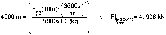

The J component states that the time of the event will be 10 hours. When Eqn-11 is multiplied by the unit vector, I, the following expression is obtained:
Equation (12): 4000 m = |F|_avg tow t²_safe / (2m)
(12) This "I - component equation, results from scalar multiplication of Eqn-14 by
the unit vector, I.
The duration of the event is known. It can be entered into the above equation to yield a solution for the Average Towing Force.
Equation (13): 4000 m = F_avg tow (10 hr)² (3600 s/hr)² / [2 (800 × 10⁶) kg], ∴ |F|_avg towing force = 4,938 kN
(13) The I - component when combined with the result of the J - component
yields the average value of the towing force required of the tug.
The answer as to the force the towing cable must withstand is quite approximate. Its greatest value might be that we have no other number. The nature of any assumption is to return a "rosy" answer. Our calculations do not tell us how strong the towing line must be. Our calculations tell us that any line with a strength less than our answer will fail.
