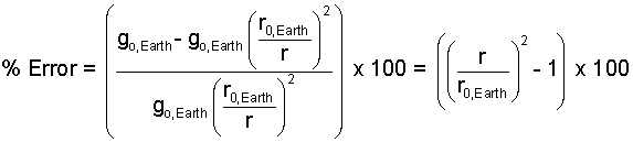

Gravity expressed mathematically in its "inverse-square" form and its approximated, Earth-surface, value are written below.
Leftmost is the actual value of gravity at an elevation. Immediately left is our approximation.
The percent error of using the constant, surface-value of gravity up to some elevation r, is written below then algebraically reduced. approximation that a constant (surface value) for the acceleration of gravity for all elevations (of altitudes) reduces algebraically to:
of approximation clearer.
This result makes sense, it says the error increases with altitude. Using some numbers, the Earth radius is about 6367 km, so the error for use of the constant at an altitude of 30 kilometers is approximately:
This is a very small error. We should use the surface value of gravity for every engineering event that occurs at an elevation less than the peak of Mt. Everest.
The error is less than 0.9% for all altitudes less that 30 kilometers. The "positiveness" of the error indicates that the surface approximation is too large a number. But in error by only 0.9%.
