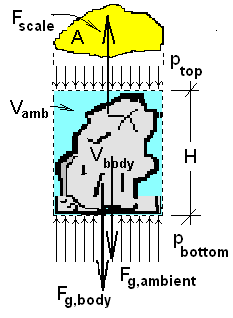

♦ By Suspension Scale:   As our system, we envisage a vertical, generated cylinder that bounds the model along with some air inside of it and beside it. The horizontal top of the system, where our cylinder contacts the top of the model, has the constant pressure of the atmosphere, patm,top. Across the flat bottom of the model, the atmospheric pressure is patm,bottom. The sketch below right shows our system, extracted from its physical reality - represented as a "free-body-diagram."
Newton's Second Law is applied to the system as follows:
Free-body diagram of a suspended body of volume V_body and height H in ambient fluid: scale force F_scale upward, pressure p_top on the top area A, p_bottom on the bottom, gravity on the body F_g,body and on the displaced ambient fluid F_g,ambient.
Equation (1): [m dV/dt (air and model, 0XZ, struck out as zero) = ΣF_grav + ΣF_surface] • K
(1) 1
We scalar multiplied by K to get the vertical parts. Of gravity forces, there are two. The surface forces are that of the scale and the pressure-forces , top and bottom.
Equation (2): 0 = −m_air g_o − m_model g_o + F_scale − p_atm,top A + p_atm,bottom A
(2) 2
We will substitute to represent the masses as densities times volumes. Also there is a relation between the atmospheric pressures, top and bottom.
Equation (3): m_air = ρ_air V_air; m_model = ρ_model V_model; and p_bottom = p_top + ρ_air g_o H
(3) 3
Next we make substitutions and apply careful algebra. Check these steps!
Equation (4): 0 = −ρ_air g_o V_air − ρ_model g_o V_model + F_scale − p_atm,top A + (p_atm,top − ρ_air g_o H) A
(4) 4
The above equation, condenses considerably with further algebra.
Equation (5): 0 = ρ_air g_o V_model − ρ_model g_o V_model + F_scale
(5) 5
This reduction, known 200 or so years ago, lead to a famous interpretation. When the first two terms are grouped together, a new idea, a new force appears - the buoyant force. To others buoyancy is a pseudo-force, a conclusion by algebraic combination of pure body and surface forces. That aside, our solution of the volume is at hand. All quantities superscripted asterisk (*) are known. providing a solution for the desired quantity superscripted (?).
Equation (6): 0 = (ρ*_air − ρ*_model) g*_o V?_model + F*_scale
(6) 6

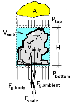

Free-body diagram of a body of volume V_body and height H supported from below in ambient fluid: pressure p_top on the top area A, p_bottom below, gravity forces F_g,body and F_g,ambient downward, and scale force F_scale.
♦ By the Platform Scale: Of course we must obtain the same answer as above. This approach, however, poses an interesting question. Our system is the model. We represent the force of the scale (awkwardly drawn in the sketch) as a single force vector. Starting with the "weighing scenes" image above, imagine the changes as the suspending cord pays out, lowering the model to rest completely, in full contact flatly, upon the face of the depressed platform scale. As the model (as system) contacts, abuts the flat face of the scale does the pressure-force (patm,bottomAface) vanish as forces "equal and opposite" do upon contact.
The answer is no. The pressure-force would vanish only if we included the supporting plate as system. An if we include the plate, we must account for its gravitational force and we must draw a new, lower boundary. Logically that boundary would be the bottom of the plate which contacts air. If System A contacts System B and you want a new perspective (A + B) then draw a new picture. The atmospheric pressure-force distribution is retained.
