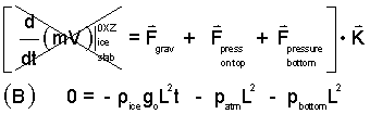

For more information, the momentum equation is applied to a section of ice slab in its initial, floating state. The sketch (right) shows the isolated system bounded by its "dotted line." The momentum equation is applied.
Equation (5): [d(mV)/dt (ice slab, 0XZ, struck out as zero) = F_grav + F_pressure on top + F_pressure bottom] • K; (B) 0 = −ρ_ice g_o L²t − p_atm L² − p_bottom L²
(5) 5

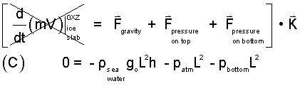

Scenario of ice floating in water, and the adjacent column of water of height h as system with forces: p_atm A on top, weight ρ_liq g A h, and p_bottom A from below. This provides another equation but it brings another unknown, pbottom. A final available condition is that of static equilibrium of the water adjacent to the ice. The system is shown (right). We write the momentum equation for a column of water of depth h.
Equation (6): [d(mV)/dt (ice slab, 0XZ, struck out as zero) = F_gravity + F_pressure on top + F_pressure on bottom] • K; (C) 0 = −ρ_sea water g_o L²h − p_atm L² − p_bottom L²
(6) 6
Again, pbottom appears, but it has already been counted as an unknown. Thus the equations (A), (B) and (C) can be combined to yield the expression:
ρliqW2(H2 - H1) = 0
(7)(7)
When the product of three quantities equals zero, one quantity must equal zero. Obviously ρliq is not zero. W is not zero. Hence, it must be that:
H2 - H1 = 0
(8)(8)
Thus when ice floating in the sea melts the average depth of the ocean does not change. However, when ice that is initially on land melts, the average sea level rises.
