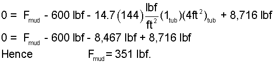

pairAtubs = 8,716 lbf.
Finally we put those numbers into the momentum equation 1) to calculate the force of the mud Fmud. If the force of the mud is positive (upward), mud is still supporting the car so it will not lift. But if the force of the mud is negative, the car will float (provided it is not stuck in the mud).

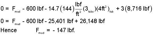

So for one tub the supporting force of the mud is 351 lbf. This means the car won't float, more tubs will be needed. The calculation with three inverted tubs is:
Great! If three tubs are used, either the mud maintains a downward force (pull) of 147 lbf on the car, or the hulk will float.
