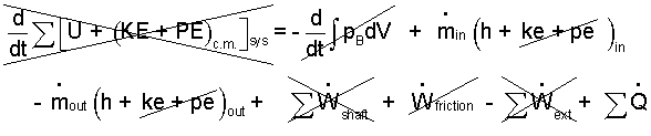

Of the system equations, the energy equation is the longest. It is a check-list of energy changes and causes. So we write it and put the "X"" over what is zero and the "/" through what is assumed small and is being neglected. For this consideration, the energy equation reduces as follows:
Equation (1): d/dt Σ[U + (KE + PE)_c.m.]_sys (struck out) = −d/dt ∫p_B dV (struck out) + ṁ_in (h + ke + pe)_in − ṁ_out (h + ke + pe)_out (ke and pe struck out) + ΣẆ_shaft (struck out) + Ẇ_friction − ΣẆ_ext (struck out) + ΣQ̇
(1) 1
The energy equation reduces to a single stream flow with heat.
Equation (2): 0 = ṁ_in (h_in − h_out) + Q̇
(2) 2
