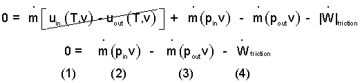

Upon its definition, internal energy was considered a dependent property with temperature and specific volume as its independent variables, u = u(T,v). The flow is incompressible, meaning vin = vout. Also there being no heating mechanism, the entering and leaving temperatures are equal (or near so). Our reduced equation is:
Equation (7): 0 = ṁ [u_in(T, v) − u_out(T, v)] (struck out) + ṁ (p_in v) − ṁ (p_out v) − |Ẇ|_friction; 0 = (1) ṁ (p_in v) − (2) ṁ (p_out v) − (4) Ẇ_friction
(7)7
The resulting equation has four terms. Term (1) has the numeric value "0." The thermodynamic meaning of this "0" is the system energy is constant in time. Also and obviously, the "0" means the right-of-equality terms sum to zero. Terms (2) and (3) represent energy entering and leaving the pipe with the mass flow. More energy enters than leaves. Energy is dissipated frictionally (internal mechanical equilibration) as it flows.
