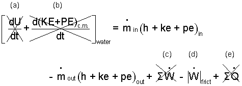

Energy Equation
The system is the water within our prescribed boundaries. The beginning energy equation is:
Equation (4): [(a) dU/dt (struck out) + (b) d(KE + PE)_c.m./dt (struck out)]_water = ṁ_in (h + ke + pe)_in − ṁ_out (h + ke + pe)_out + (c) ΣẆ (struck out) − (d) |Ẇ|_frict + (e) ΣQ̇ (struck out)
(4)
For "steady behavior, system
dE(t)/dt equals zero.
Terms "left-of-equality" are struck out. (a) Within dU/dt, U is an integration over the system of increments of du. Internal energy is a function of temperature and specific volume: U = U(T,v). We assume the temperature and specific volume of the water does not change hence dU/dt = 0. (b) Kinetic energy and potential energy changes relate to the center of mass of the water which does not move. There are no work effects, (c), by turbine, paddle-wheel or such. However, work of flow friction is identified,(d). The friction work term is written to include that it is always negative. Thus its effect appears as an energy loss of the flow. The sum of heats (e) equals zero.
To continue, since the system substance is incompressible, it is convenient to represent enthalpies of the flowing streams as: h = u + p/ρ (where ρ = 1/v.
Equation (5): 0 = ṁ_in (u + p/ρ + ke + pe)_in − ṁ_out (u + p/ρ + ke + pe)_out
(5) We continue to carry the friction work.
By Eqn-2 entering and leaving mass rates are equal so divide Eqn-5 by the mass rate. Specific internal energy of simple compressible water is a function of its temperature and specific volume, i.e., u = u(T,v). We take the entering temperature and density of water to equal that of the leaving water. Thus uin(T,v) equals uout(T,v). The entering and leaving specific internal energy flow rates of the water sum to zero. Next, we represent the specific kinetic energies explicitly noting that Vin,avg as negligible. Potential energies have the surface of water as datum. Elevation at the water surface is set to "0".
