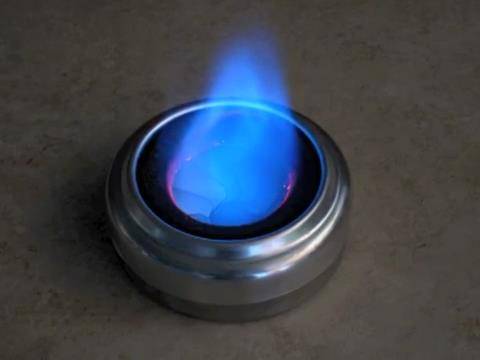

Good day to everybody,
I'm wondering whether it could be possible to improve the quality and efficiency of an ordinary (wax/paraffin) candle flame.
These flames are relatively cold, and give off a substantial amount of soot (i.e. unused fuel).
I wish to raise the temperature of the combustion products in order to increase the quantity of thermal energy released by the candle.
I don't know whether it's possible to steer a candle flame from reducing (yellow) to oxidizing (blue).
I've heard of "simmer rings" - used with alcohol burners, not with candles - that produce a beautiful blue, hot flame (see attached picture).
I could not find the details of these rings, I don't know whether they can be built and work successfully when coupled to a candle.
There are widely diffused miniature butane torches, based on an inexpensive cigarette lighter, that produce an extremely hot, blue flame instead of the usual yellow flame of the lighter: but it works only because the butane in the lighter is under pressure so it can be used to draw in a substantial amount of air, producing a nice oxidizing flame. Nothing like the wax in a candle.
...Any idea about how to do the trick?...:rolleyes:
  • Photo of a blue gas flame rising from a stainless steel burner ring, with a bright blue flame and a pink-tinged inner core.

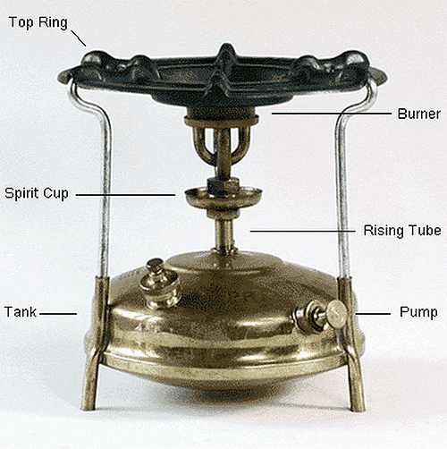

I think @DaveC426913 is on the right track.
You may (or may not) succeed in adapting a Primus Stove to use pressurized, melted paraffin from a candle as an alternative to kerosene fuel. You would need a second stove (or other candles) to keep the fuel tank hot. The chances of making that work may be small, but an experimental trial would not be expensive.
https://en.wikipedia.org/wiki/Primus_stove
Labelled photo of a brass pressure stove with a cast iron top ring, burner, spirit cup, rising tube, tank and pump, standing on three legs with wire supports.
Or some sort of passive single-stage heat shunt system.
Divert a small portion of the heat back to keeping the fuel warm.
That's how they do it in the shuttle rocket engines! The liquid fuel is passed through lines surrounding the exit nozzle to warm the fuel up to temp before squirting it into the chamber.
You'd want to minimize loss by minimizing the distance between heat and fuel. I suspect that arranging the fuel reservoir so that it sits adjacent to some of the heat would be good. Like a donut fuel reservoir with the flame in the centre-bottom.

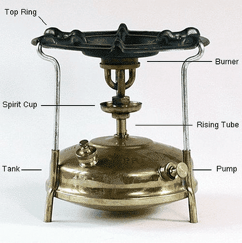

Have you looked for affordable sources of ethanol in your country?
Primus stoves aren't readily available here, not even from internet stores. In addition, we must use the tealights "as they come": we cannot melt the paraffin out of them to reuse it, for a number of good reasons.

A Primus stove is almost as simple as you can get. If you can't buy or make something like that, I don't think there is anything simpler.
Cooking with the heat of yellow candles may be the best they can do.
