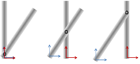

ok, this is the picture as simple as it gets.
3 images, one after another, as 3 steps in time.
https://docs.google.com/file/d/0B96oKqGy81PsalFidjhHM0xSLWVyQm41Wmx5REtYQQ/edit?pli=1
https://docs.google.com/file/d/0B96oKqGy81PsVDE3Ums3VnJSbXFwMzRQdURnRWptdw/edit?pli=1
https://docs.google.com/file/d/0B96oKqGy81PsalFSNHJESC1SSnVUbDd0VE1wLXhSUQ/edit?pli=1
see, if that was a ball or something, it would move sideways with the system.. but what about a photon.. (?)
Light also moves sideways, as I showed in post 7, but it's speed is still c as also shown.

Ball or photon, it doesn't matter. Your picture is incorrect in that you are not resolving the photon/bullet as it travels down the length of the laser/barrel. It will not (as seen from the planet) move parallel to the laser's axis. This is not an SR issue, it is a general motion issue.
Picture this... first forget all about Einstein's relativity. Picture two trains running side by side at the same speed. (put them on the moon so we can neglect the wind). You're on one train, shooting at a target on the other train exactly across from you. You don't have to lead the target you just aim right at it. You hit it.
Now suppose you shoot a second shot just as both trains are about to enter a tunnel. Your bullet will leave the gun right before you enter and would have hit the target right after. Instead is grazes the side of the mountain between the two tunnels. You see, there's lateral motion on the bullet equal to the lateral motion on you and the target. In fact if you stick your barrel out too far the barrel will hit the mountain while the bullet is still in it traveling up its length and you'll ruin a perfectly good rifle.
You try a third shot, this time as your train passes under an overhanging platform where I too take a shot. You don't lead your target but I, being stationary must lead. We both shoot at the same time and hit the same target at the same time. (I have a slightly higher power gun so the speeds perp. to the train are the same given my lead angle).
Now visualize both our barrels superimposed. Mine is crossing yours with an angle and relative motions so that our bullets trace out the exact same path as seen from above.
In the diagram, the blue frame is my "stationary" frame. The red is yours on the train. The point here is the bullet leaving your gun is traveling in the same direction as mine even though your aiming in a different direction.
Your error is in thinking the bullet you fire will suddenly loose its component of motion in the direction the train travels just as it leaves the barrel. It doesn't. From the ground (or my overhanging vantage) the bullet travels at an angle forward from perpendicular to the train because the barrel moves forward (perp to its aim) while the bullet is traveling down its length.
Understand that point first. Then consider what Einstein's special relativity has to say.
Light does exactly the same thing and if it were not for SR I'd need to shoot light a wee bit faster than you in order to get my pulse to hit the target at the same time as yours. Relativity resolves this by (apparently to me) having your clock run slower.
As I see it you measure the photon bullet at speed c with no motion lateral to your barrel and I see it having speed c with that extra component of motion traveling farther in a longer period of time than you measure with your slow clock.
Everything works out so everyone always sees light travel at speed c, and there's no way to say who is actually moving and who is actually standing still.

Ok, I understood already everything about the ordinary bullet scenario .. but I was confuses about light.
Now I see that time dilation, length contraction and what not will always make c .. = c
Thank you.
