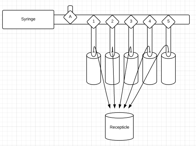

I woke up and jotted this down, I am not positive the mechanics behind it are right but let me know what you think:
Hand-drawn style schematic of a fluid dispensing system: a syringe feeds a horizontal line with valve A, branching to five numbered valves 1 to 5, each leading down to a reservoir, with arrows from the reservoirs to a single receptacle below.
  1. Processor tells piston to enter syringe at an exact distance
  2. Solenoid # opens, letting pressure into ingredient resevoir
  3. The correct volume of liquid enters recepticle
  4. A window of time is allowed for more viscous fluids to flow
  5. The # solenoid closes
  6. The A solenoid opens, allowing air into the system
  7. The syringe returns to start position
  8. The A solenoid closes
  9. Repeat
Or you mix a large batch and dispense that into many small bottles ... that gets you the accuracy too.
Right, I could do that as well, , but I'm usually low on stock of at least one ingredient. Will the exact volume of the syringe dispense the exact liquid using my example? If so, then this method could be the most accurate and useful application :)
I think you can rig a syringe to dispense exact-enough quantities for what you want.
You'll have to experiment though. There are lots of options.
Peristaltic pumps are hard to calibrate and are temperature dependent.
Maybe consider using inkjet print head technology.
