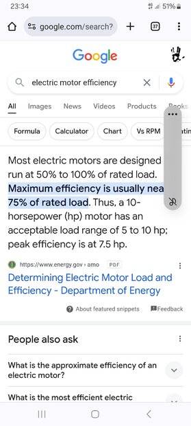

pete94857 said:
I imagine it would increase their efficiency at least 10% if not more. Less lose to heat caused by electrical resistance, less material needed because of its increased conductivity and as a material its density is less than that of copper.
Unfortunately(?) many electric motors are already above 91% efficiency so they don't have 10% left to gain.

And is the energy reclaim systems also such efficiency on electric vehicles ?

pete94857 said:
Load (units of HP) at peak efficiency) ##\neq## Efficiency (units of percent) at that load
Pete, Pete, Pete. Google is not a substitute for knowing what you are talking about.
Even if you did not make the mistake that @renormalize pointed out, if the average motor's efficiency is well under 95% does not mean that you can't make a 95+% motor. Indeed, it would show that efficiency is not the only factor in the selection of a motor. (Hint: it's not)
