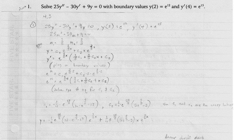

D.E. Boundary Value Problem: Finished the work, seem to get wrong ans

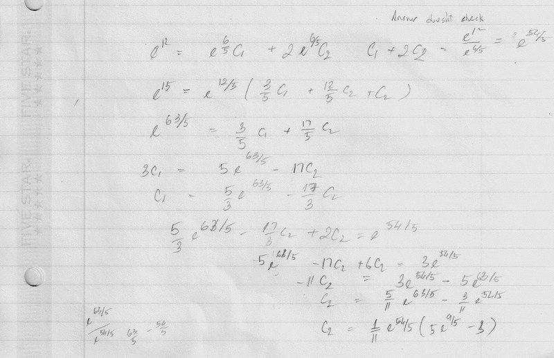

I get what you have until you say "solve sys of eq for C1 & C2" but do NOT get the values for C1 and C2 that you do. Unfortunately, you don't show how you solved the equations.
There's the work. In addition, my Ti-nSpire CAS also solves it and gets that answer.
