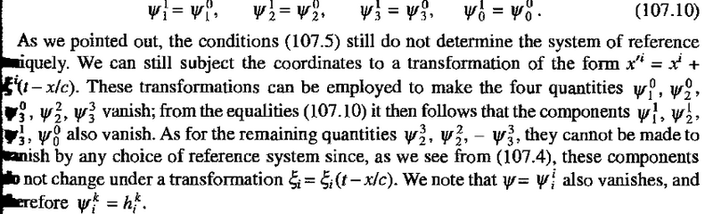

In Landau-Lifshitz Classical Theory of Fields
Wave coordnates are introduced to eliminate non-essential components of h.
