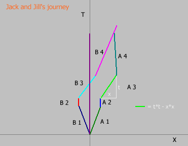

What a pathetic thread.:cry: It's like arguing about the size of sqrt(2) when you could just calculate the value. Instead of handwaving and guesswork, why not draw the worldlines for the scenario in question and calculate the proper-times ? It's called 'science', some of you may have heard of it.:biggrin:
After my disrepectful remarks :redface:, I have no choice but to draw the diagram myself. I think each traveller has 4 phases of which I've labelled A 1, B1 etc. The small triangle and text show how to calculate the proper-time for each leg. Maybe GRDixon can fix the pic to fit his scenario and work out the proper-times. I had some trouble understanding when the changeovers happen after phase B. The purple line is the worldline of someone at L/2, from whose viewpoint the diagram is drawn. ( whoops, the origin is at L/2, makes no difference).
  • Minkowski spacetime diagram with time axis T vertical and space axis X horizontal, showing Jack's and Jill's worldlines split into labelled segments A 1 to A 4 and B 1 to B 4, with a small triangle labelled t and x and the formula t*t - x*x.
I'll have a go, but must confess that I'm just now reading "Relativity Simply Explained" by Martin Gardner. In brief, I'm out of my depth, at times, with some of the bright young minds who express their views on Physics Forums, particularly in GRT. I had a look at your diagram and like it! I'm going to learn how to do this stuff. At 71, I expect it's not going to be as easy as things were 50 years ago (ouch!) at MIT. But I know that it will be as much fun as ever. Speaking of GRT, I was anticipating more comments to my doggerel thread a la the Equivalence Principle. Thanks for commenting. Yours in Physics, GRD.

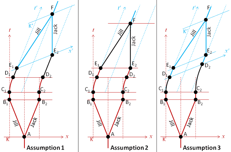

The wording is still a little ambiguous, so I've drawn two possible diagrams. They both start the same.
(A) Jack and Jill begin moving apart, each at v relative to K in opposite directions
(B) They come to rest in K, simultaneously in K
(C) They start to accelerate identically, simultaneously in K.
(D) When they each reach a speed of v relative to K, they stop accelerating. This will occur simultaneously in K. At this point, both are at rest in K'.
Up to this point, by considering the symmetry relative to K, the proper time (i.e. time experienced by Jack or Jill) for each stage (A-B, B-C, C-D) is equal for Jack and Jill. So at the events D1 and D2, Jack and Jill are the same age.
This is where I now have to make an assumption.
Assumption 1 (left hand diagram)
(E) Jack and Jill begin moving towards each other, each at v relative to K' in opposite directions simultaneously in K'
(F) Jack and Jill meet and come to rest relative to K'.
Because K and K' have different definitions of simultaneity, Jill ages less from D1 to E1 than Jack does from D2 to E2. Now considering the symmetry relative to K', Jack and Jill age the same amount from E to F. Over the whole journey the only segment where there's an age difference is D to E, where Jack ages the most.
Assumption 2 (right hand diagram)
Jack and Jill age the same amount from D to E. From E to F, Jack is moving slower than Jill relative to K, and so ages more. Over the whole journey the only segment where there's an age difference is E to F, where Jack ages the most. So, same outcome as assumption 1.
I suspect the questioner intended assumption 2, and may also have intended that the B-C and D-E segments are all zero duration.
That is so fine. I did have Assumption 2 in mind, but both are interesting. Now if I could only tie this in with the Equivalence Principle ... :) Muchas Gracias.
I'm glad my intuitive hunch that jack ages the most with either assumption was correct (this time). :smile:

Actually the example you gave isn't quite equivalent to being at rest in a gravitational field. At the C events, in my diagram, Jack and Jill are a distance L apart, measured in K. Because of the specific way you specified the acceleration, they are still a distance L apart, measured in K, at the end of the acceleration, the D events. Because this length must be contracted relative to the length measured in K', Jack and Jill are at a greater distance apart, measured in K. From their own point of view, they move apart during the acceleration phase, and do not consider each other to be at rest. For more about this, look up "Bell Paradox".
To make the experiment equivalent to the gravitational case we need to modify it slightly.
Assumption 3
(C) They start to accelerate in such a way that they regard themselves to be at rest relative to each other. This is called "Born rigid" acceleration. To prevent the moving apart that occurred under the other assumptions, Jill must accelerate at a higher rate than Jack. As measured by K, Jack and Jill get closer to each other.
(D) When they each reach a speed of v relative to K, they stop accelerating. This will occur simultaneously in K'. At this point, both are at rest in K'. Because Jack's acceleration was lower, it took him a longer time to reach v along C2-D2 than it did for Jill along C1-D1.
Now considering the symmetry relative to K', Jack and Jill age the same amount from D to E to F. Over the whole journey the only segment where there's an age difference is C to D, where Jack ages the most. Again, the same result as assumptions 1 and 2, but under assumption 3 Jack and Jill consider themselves to be at rest relative to each other from B to E.
