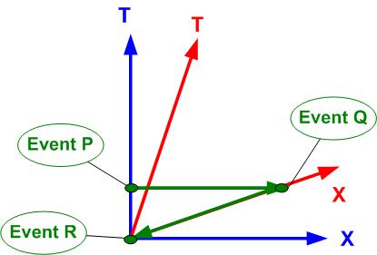

I will make a try at an explanation myself. In the end it is a simple triangle, like this:
Imagine a duel on a Train (red frame), the same duel that Brian Green describes in The Fabric of Cosmos. Duelers (Back and Front) shoot when they receive light signals from the mid-point of the wagon. Now, when Back is warned by the corresponding signal, a guy by him on the Ground (blue frame), shoots at Front (event P). He shoots a superluminal bullet (let us imagine, for simplicity, an instantaneous one) and wounds Front... when? If you follow with your finger the simultaneity blue line of the Ground frame (horizontal), you see that Front would be wounded at event Q. In the Ground frame, that means that Front is hurt before receiving its own signal. That is already unfair enough. Now Front Fires back the same bullet, which is supposed to travel also instantaneously. When does it hit the aggressor? If you follow with your finger the red simultaneity line of the Train frame (descending), you will find out that the aggressor is punished before he committed his own felony. So the bullet in question has traveled back in time and this has created an inconsistency, a paradox.
All this looks like an orthodox application of SR math and geometry, except that it is combined with FLT, which in principle SR rules out, but what if experiment re-introduces it?
However, as I said, it is quite obvious that, even if FLT were possible, those paradoxes would not happen. If some people fear they could, it is because they misinterpret the concepts. If I had to put it briefly, I would say that the error is mixing up the old absolute simultaneity concept with the relative simultaneity concept introduced by SR.
I see your point and I also see there are many contradictions in your example:
the very first contradiction is the use of relativistic simultaneity concept; this concept lies on an axiom which states that every event spreads through the spacetime at velocity c. This is in contradiction with our axiom "exist one object which can travel at FTL speed".
In your example this contradicion leads you to tell that simultaneity (simultaneity based on FTL speed) from P to Q is not the same from Q to R (because you here use simultaneity based on c speed). In fact your image shows that the P-Q arrow goes back in time from time tP to tQ(=t0) in the red X line, which is obviously wrong.
Furthermore your example is complicated because the train is moving from the ground point of view and this fact complicates the maths.
