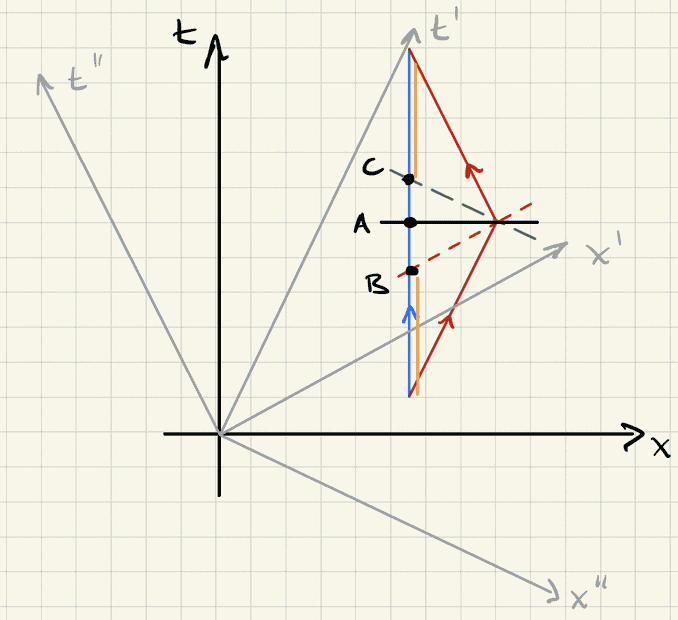

For reference, this is the full twin paradox diagram from my hand-written lecture notes (the ones I lecture from as opposed to the ones I put into LaTeX, which I suggest students read):
The axes of three inertial frames are shown: S - rest frame of "staying" twin, S' - rest frame of "travelling" twin in the outbound leg, S'' - rest frame of "travelling" twin in the inbound leg.
It shows the "staying" twin's world line in blue and the "travelling" twin's world line in red. A/B/C are events on the "staying" twin's world line that are simultaneous to the turn around in S/S'/S'' and the dashed lines are the corresponding simultaneities.
The yellow lines mark the parts of the "staying" twin's world line that are covered by the "paradox" argument where time dilation is applied without taking relativity of simultaneity into account.

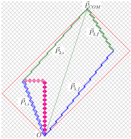

From my Insight,
https://www.physicsforums.com/insights/relativity-rotated-graph-paper/
Note that there are six reference frames here: Alice, the four incoming and outgoing particles, and the COM frame. Since the k-factors of the particles (and Alice) are rational numbers, we can easily draw (and thus count) their unit-mass-diamonds on Alice’s diagram. However, since the COM frame does not have a rational k-factor (and thus not a perfect square for its square-mass) we can’t easily draw the unit-diamonds in that frame… but we can calculate practically everything of physical importance.
Source: https://www.physicsforums.com/insights/relativity-rotated-graph-paper/
