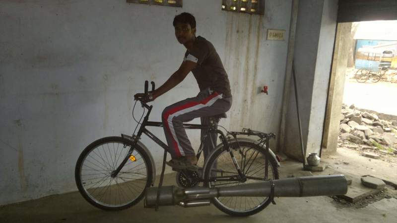

this is my second pulsejet which is self sustained..iam just holding the injector using the air gun..and trying to adjust the injector for good thrust.this is a successful thrust you could see the cycle shaking due to the thrust produced by the engine..this will be clearly visible from 0:50..
design by: metiz (thanks for the help sir)
That's cool, the exhaust looks non-steady tough, I'm sure you can improve it.
I wanted to make one too and build an RC airplane around it but they are very inefficient (and really loud)

you can fix it in RC planes it will be cool..because in my video you could see the engine thrust shaking the bicycle..
Very cool. Can you lengthen the exhaust a little for sustained combustion? From what I understand a good portion of the exhaust resonates back up the exhaust tube to compress and ignite the next cycle.

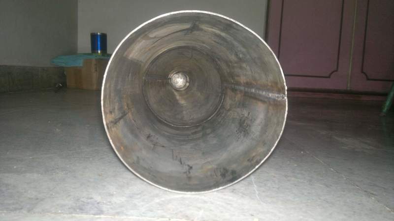

My mistake. Still very cool. It's difficult to tell the proportions from the end-view. I would try to make one myself but I couldn't get away with it. It would really piss off the neighbors.

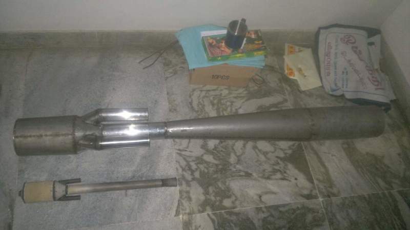

here are the pictures,you could see the engine clearly..

Very nice weld work. Do you have a small propane tank you can mount on the bike?
iam not using propane tank,instead iam using LPG tank(15kg)..
LPG is short for liquid propane gas. You can buy these in little 14 and 16 oz. canisters that might serve will on a bicycle.

i think its liquefied petroleum gas..because it contains mixture of propane and butane..this engine requires more fuel 16oz is not enough to start the engine..
