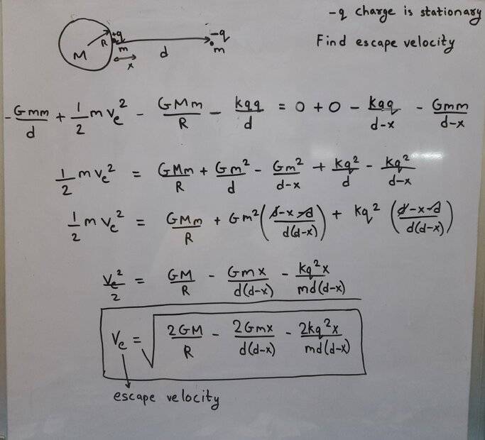

Sorry moderators i am still learning LaTex so i had no other choice

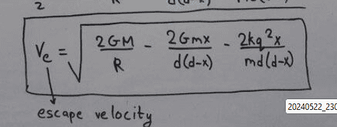

So i tried calculating escape velocity for a charged body of mass (m) and charge (+q) when a charged body (-q) is present at a distance (d) and kept stationary. I equated the Gravitational potential and electrostatic potential energies for initial and final and i got this expression(without any approximation for x<<d or d tends to infinity) . I would like to know if what i have derived is correct or have i done something wrong
How do you define escape velocity? It looks like you messed up the energy conservation equation. On the left you have the initial configuration when the mass starts at d from the charge with initial speed ##v_e##. On the right you have an expression saying that the mass is closer to the charge and has zero speed. How can that be if there is an attractive force between the mass and the the charge? The speed should increase as the two get closer together.
Also, both electric and gravitational potential energies should be written as if all the mass and all the charge of the charged body were concentrated at its center.
Also, why are there two gravitational terms, ##-\dfrac{GMm}{d}## and ##-\dfrac{GMm}{R}## on the left hand side?
Also, you will be well-advised to ignore the gravitational energy. ##G## is 21 orders of magnitude lower than ##k##. If you ignore gravity, your expression gives an imaginary number for the escape velocity.

Gotta love the combination square root and answer box, though. I think that's the first time I've seen that. :smile:

The two gravitational terms were for potential of the mass towards planet and potential of mass towards charge.But yeah i did not see the imaginary number thing .Ill try to improve the formula again by today night

Oh that was by accident , i did not even notice that till now sorry haha

Yeah, try to do that with your LaTex!

Planet? What planet? At that scale gravity will dominate any realistic electrostatic force.
You would be better taking a fixed central charge of ##Q## and a charge ##q## of mass ##m##. Where the charges have opposite signs.

Why not equate the (negated) total potential energy (using infinity as reference) to kinetic energy?
Isnt that what i did , the gravitational potential energy of the mass towards both planet and charge?
