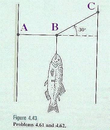

I have the solution for the problem. I just don't understand HOW this formula was derived. It came from another student, and nowhere in the text has our teacher taught us how do something like this..

What is the force exerted by the string on the wall at point A in the figure if the suspended fish has mass m = 0.56 kg?
m * g * (Square root of 3)
.56 * 9.81 * (square root of 3) = 9.52 N .. but why would you use the square root of 3 here? 30 degrees?

Yes, the attachment is there. You need to say that the sum of all the forces in the x direction is zero and the sum of all the forces in the y direction is zero. Can you write
1. An expression for the sum of all the forces in the x-direction
2. An expression for the sum of all the forces in the y-direction

Use kuruman's advise on how to go about this problem. The advise is sound. Since you know that the fish is not accelerating, the sum of all the forces in a given direction must be zero. So you can just sum them up as kuruman advises, knowing the net force in any direction is zero.
By the way, if you are wondering where in the heck a [tex]\sqrt {3}[/tex] fits in, here are a couple useful trig identities. You can check these using the Pythagorean theorem if you wish. Again though, follow kuruman's advise on how to solve this problem, but in the process you may find these identities useful.
[tex]sin(30 ^{\circ}) = \frac{1}{2}[/tex]
[tex]cos(30 ^{\circ}) = \frac{\sqrt{3}}{2}[/tex]

You need to sum all the forces in each direction, such that they sum up to zero (in a particular direction), like Kurman says. It's more than just summing up sines and cosines of angles alone.
In other words, you need to take the tensions on each string into account too, as well as the gravitational force on the fish.:wink: A free body diagram is a good place to start.
Ok so I've tried to break them down and equal to zero. I'm letting T1 be AB, T2 BC, and T3 B-fish.
T1x = -T1 cos 0 = -1 T1
T1y = T1 sin 0 = 0 T1
T2x = T2 cos 30 = .87 T2
T2y = T2 sin 30 = .5 T2
T3x = 0
T3y = -T3 = -.23
T1x + T2x + T3x = 0
-1 T1 + .87 T2 + 0 = 0
T1 = .87 T2
T1 y + T2 y + T3 y = 0
0 T1 + .5 T2 + -.23 = 0
0 T1 + .5 T2 = .23
0 (.87 T2) + .5 T2 = .23
T2 = .46
T1 = .87 (.46)
T1 = .4002
so using an example I found, I got to tension 1 being .4002N which isn't right. I'm not sure what I did wrong and what I can do now to fix it.

".23kg" is in units of kg, a measurement of mass. Forces (in the SI system) have units of Newtons. :smile::wink::-p
