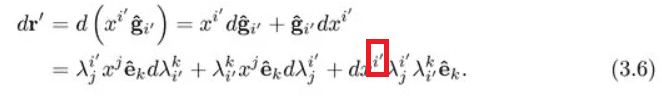

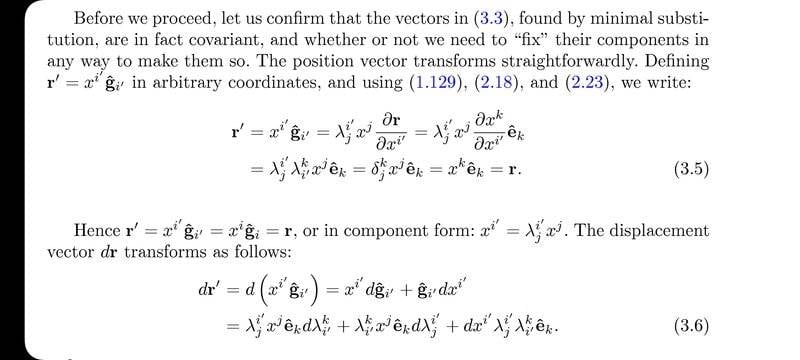

I am a physics enthusiast reading Covariant Physics by Moataz H. Emam. In his chapter about Point Particle mechanics there is a transformation equation for a displacement vector. I don't see how he arrived at the final equation 3.6. Is it a chain rule or product rule? Can't seem to figure it out. See attachment. Thanks in advance for any insight.
It's a bit difficult to read. Also, perhaps needs some context re the author's notation.

Sorry. I tried a screenshot from Kindle instead. I am able to click on it in my smartphone and make it full screen and is legible. The author is showing the covariance of classical mechanics using Einstein index notation. In this instance he is showing the transformation of the position vector which is straightforward and then the transformation of the derivative of the position vector. His point is to show ot transforms like a tensor and is therefore invariant.
eq 3.6 has a typo, this index should read ##j## https://web.cortland.edu/moataz.emam/
The derivation is straight-forward:
Use that ##\hat{ \textbf{g}}_{i'} = \lambda^k_{i'} \hat{ \textbf{e}}_k ## and ##x^{i'} = \lambda^{i'}_j x^j##.
We get ## d\hat{ \textbf{g}}_{i'} = \hat{ \textbf{e}}_k d \lambda^k_{i'} ## and ##x^{i'} = x^j d\lambda^{i'}_j + \lambda^{i'}_j dx^j##.
And you will obtain the final step in that equation.

Everything with primed coordinates was replaced with its transformation. So x’=lambda x and so on.
