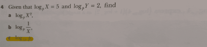

Given that, $$log_p X=5$$ and $$log_p Y=2$$.
Find $$log_{xy} P$$
Logs
Interesting, i have not worked on logs with conjoined bases before, anyway my approach is as follows;
$$p^5=x$$ and $$p^2=y$$
Let $$log_{xy}P = m$$, →$$(xy)^m = P$$
$$(P^5⋅P^2)^m = P^1$$
$$P^{7m}=P^1$$
$$m=\frac {1}{7}$$
Any other way of looking at this is most welcome.
[tex]\log_{xy}(p) = \frac{\log_p(p)}{\log_p(xy)} = \frac{1}{2 + 5}.[/tex]
You are, of course, assuming that x = X, y = Y and p = P. Or just being inconsistent in your notation.
I have been thinking about this question and my bad:mad:, i did not indicate the letters in the right manner. Find the question below as it appears on the textbook;
Textbook problem 4: Given that log_p X = 5 and log_p Y = 2, find (a) log_p X^2, (b) log_p (1/X), (c) log_p (XY), with part c highlighted in yellow.
This implies that, my method was after all correct! Sorry for my lack of details here...

Kindly check my post ##5##...i did not capture the question correctly...My apologies mjc...
