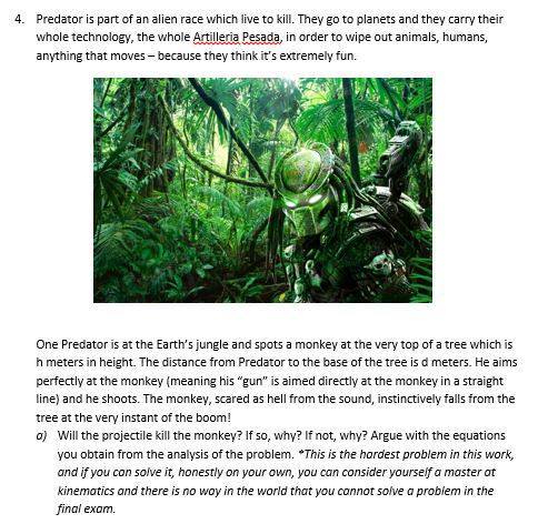

674411ST Messages 1 Reaction score 0 Thread starter May 19, 2015 #1 Wouldn´t it depend on the gun and the speed of its "bullet"? Not sure what this question refers to. Attachments 11281725_850348528335706_546577126_n.jpg 54 KB · Views: 458
CWatters Science Advisor Homework Helper Gold Member Messages 10,546 Reaction score 2,324 May 19, 2015 #2 This is in the homework section please use the template. Try drawing the situation showing the rough path of the bullet assuming it hits the falling monkey. What equations are relevant?
